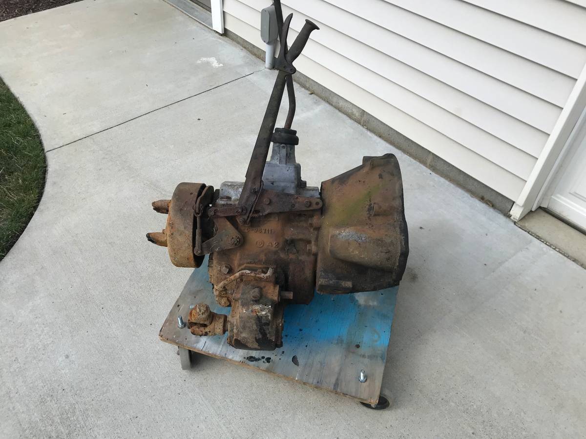

You could go old school on the e-break
Ya gotta love the ratchet handle! That thang's got style.
