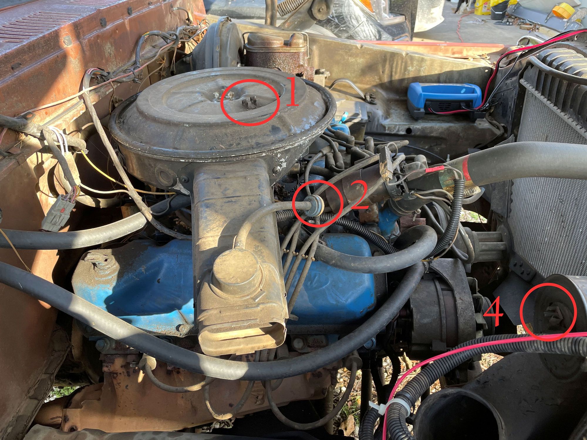

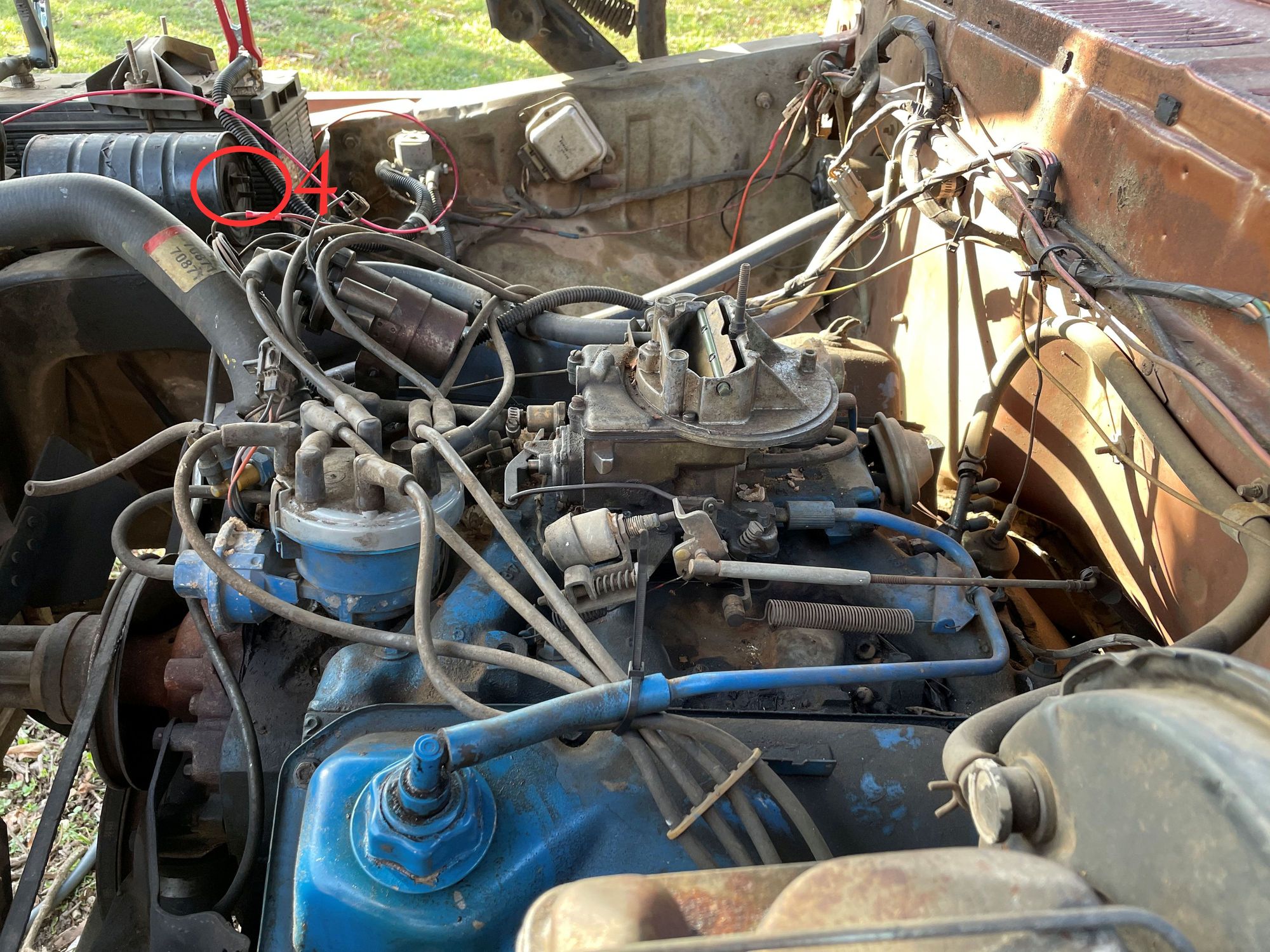

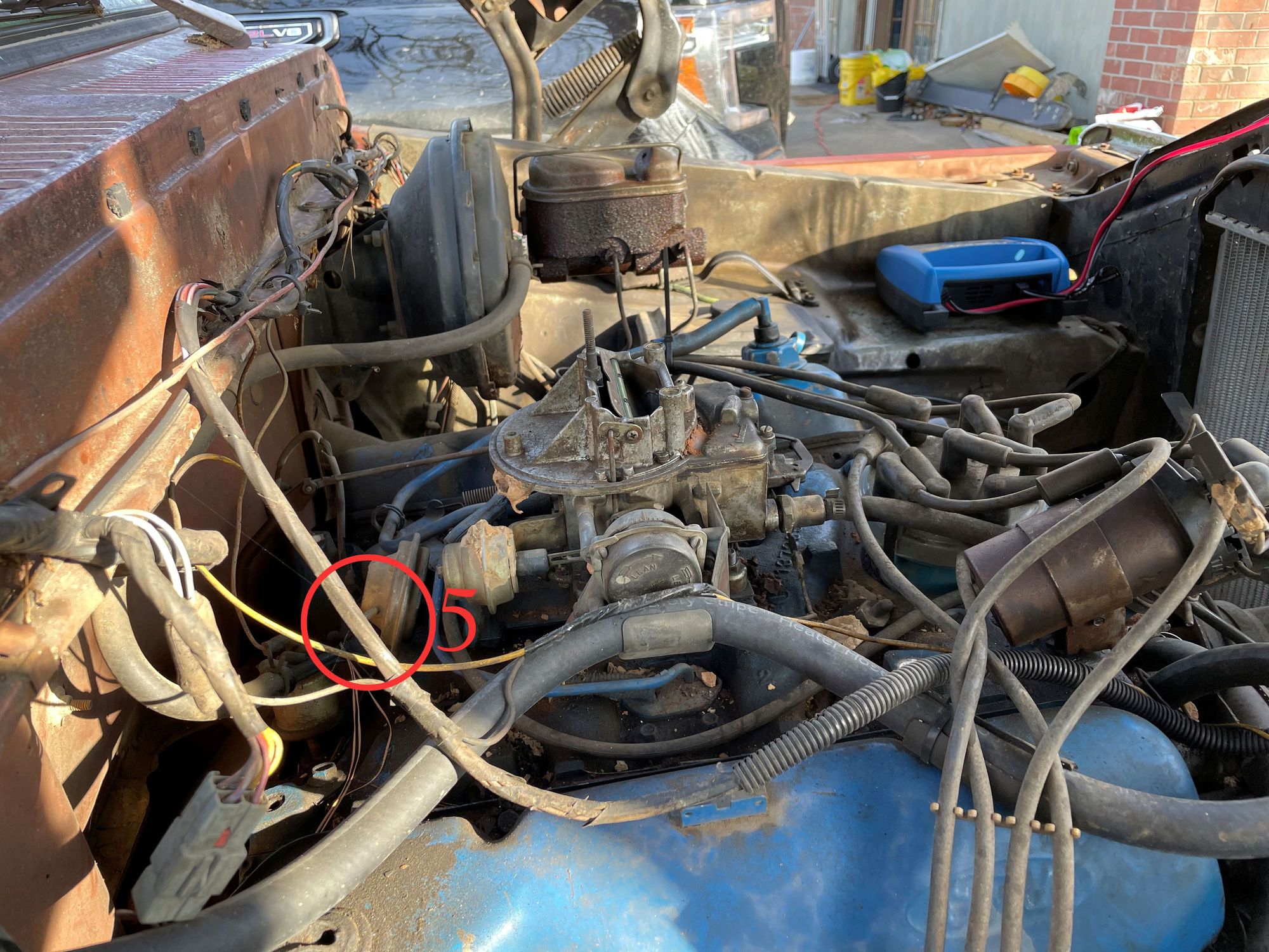

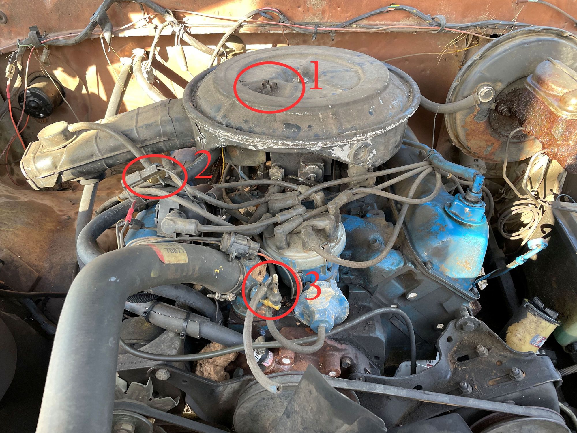

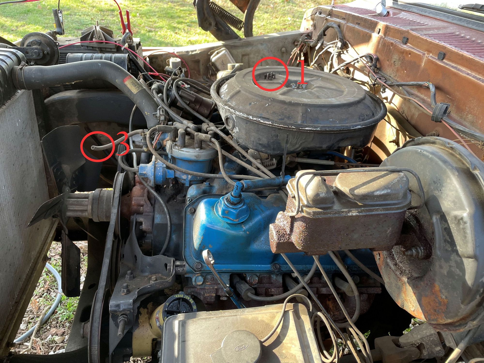

The truck won't idle. Once it's up and running it's ok... not the best, but runs. Once you stop, it dies if you don't feather the gas. I'm starting with vacuum hoses that are missing. Can anyone connect the dots for me on these missing hoses? Or, if you can post a picture of your engine with the correct hoses, I can figure it out from there. Thank you!!!

#1 Not sure
#2 Opens/closes the flap in the air cleaner. When the truck is cold it’s shut and gets hot air from around the exhaust manifold. When it’s warm it opens and draws cool air in. I think it should be connected to the temp switch I talk about in #3.
#3 is a temperature activated switch. When the engine reaches temp, that switch should allow vacuum from manifold to open the EGR valve (#5).
#4 is a vacuum canister. I’m pretty sure it provided a “reserve of vacuum” if you will.
#5 Is the EGR valve. It circulates some exhaust into the intake to re-burn it for emissions reasons.
