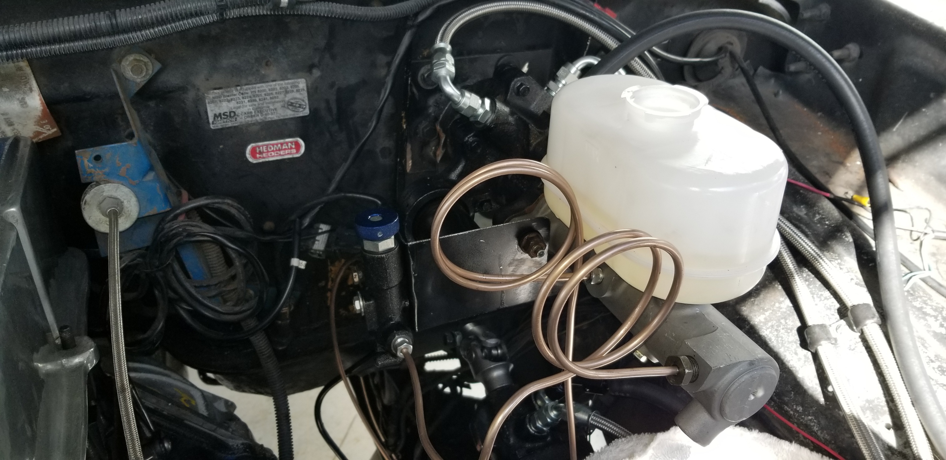

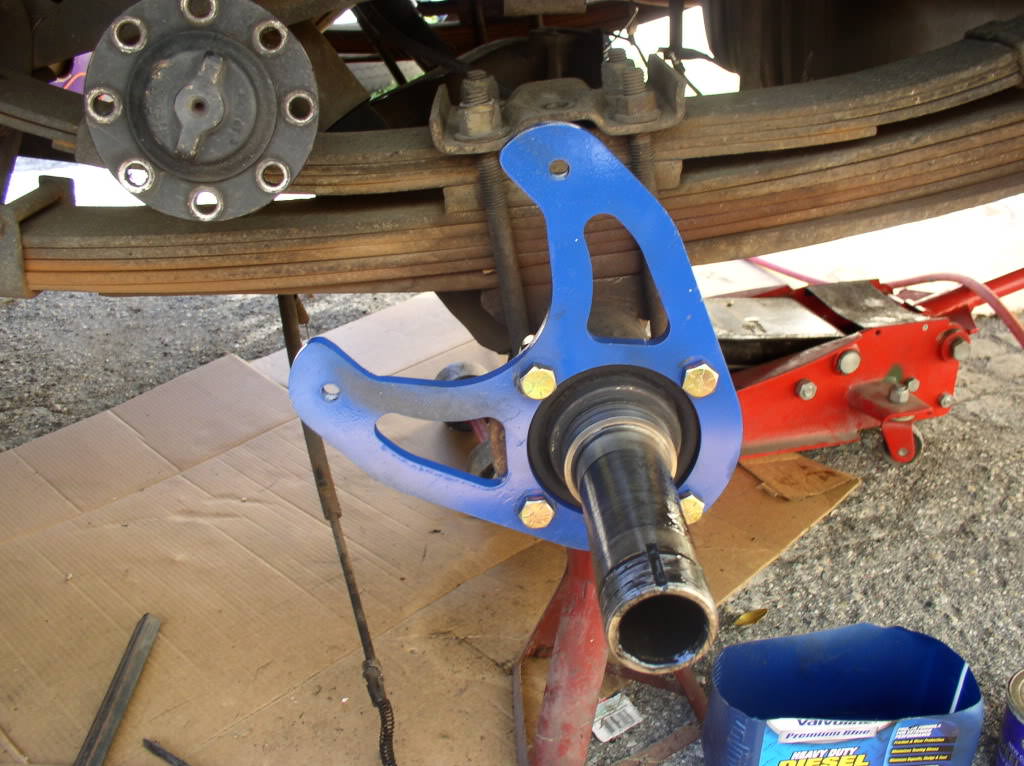

I have used hydroboost for about ... 10 years? I have a 1975 f250. I used a SuperDuty master and hydro so they would be compatible. I also swapped the power steering. to a saginaw pump with dual return lines. I used to haul and tow a lot. The hydroboost is one of the best mods I've done to the truck. The brakes are fearless.
Attachment 280175
Attachment 280176 Off a 76 LTD with a 460.
Attachment 280177
I bought the caliper brackets from a guy who sells them on ebay and some forums. They only aspect of the hydroboost was that I also installed rear discs. I used the Chebby calipers that worked great, but without a parking brake. I've tried two of the El Dorado parking brake type calipers, and the p.brake worked badly. I've considered going back to a drum set-up, but we'll see.
