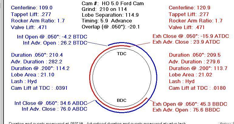

This is a plot taken from an actual non HO 5.0 camshaft. It has a 108 lobe sep and that is one of the reasons why these cores are so great to use for regrinding to make into a performance camshaft besides the overall high quality of the core.

That's right. What is interesting is how different the HO cam is from the non HO in the previous post. It has quite a bit of duration and to make that work it has the lobe sep spread out to 115. It seems like a better cam for most uses would have been to use less duration on a tighter lobe sep. It would have sacrificed power but it would have probably gained mid range torque and acceleration. These cores have the 351W firing order which doesn't matter but the big wide lobe sep makes these cores less desirable to use for regrinding which is a shame because for some reason they seem to be easier to find than the non HO.
