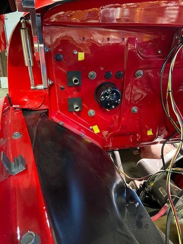

I installed the heater yesterday and now I'm figuring out the best way to install and operate a heater valve. Understanding that the OEM type valve isn't available anymore, it appears an in-line valve is the way to go. I've looked over the 4-Seasons catalog and see they are offered with the cable operators on top or bottom.
A few questions.
1. Does flow direction matter through the valve?
2. The Ford shop manual shows the hose from the pump going to the top core tube. The hose from the head going to the valve. Does it matter? I'm asking because I want the best option for cable routing.
3. All the valves I viewed need a looped end on the operating cable. Is there a way to make this? I never had any luck trying to bend the hardened cable. Also looked for some sort of adapter, no luck.
Thanks
Bob

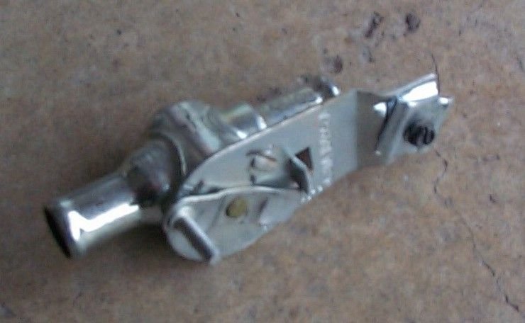

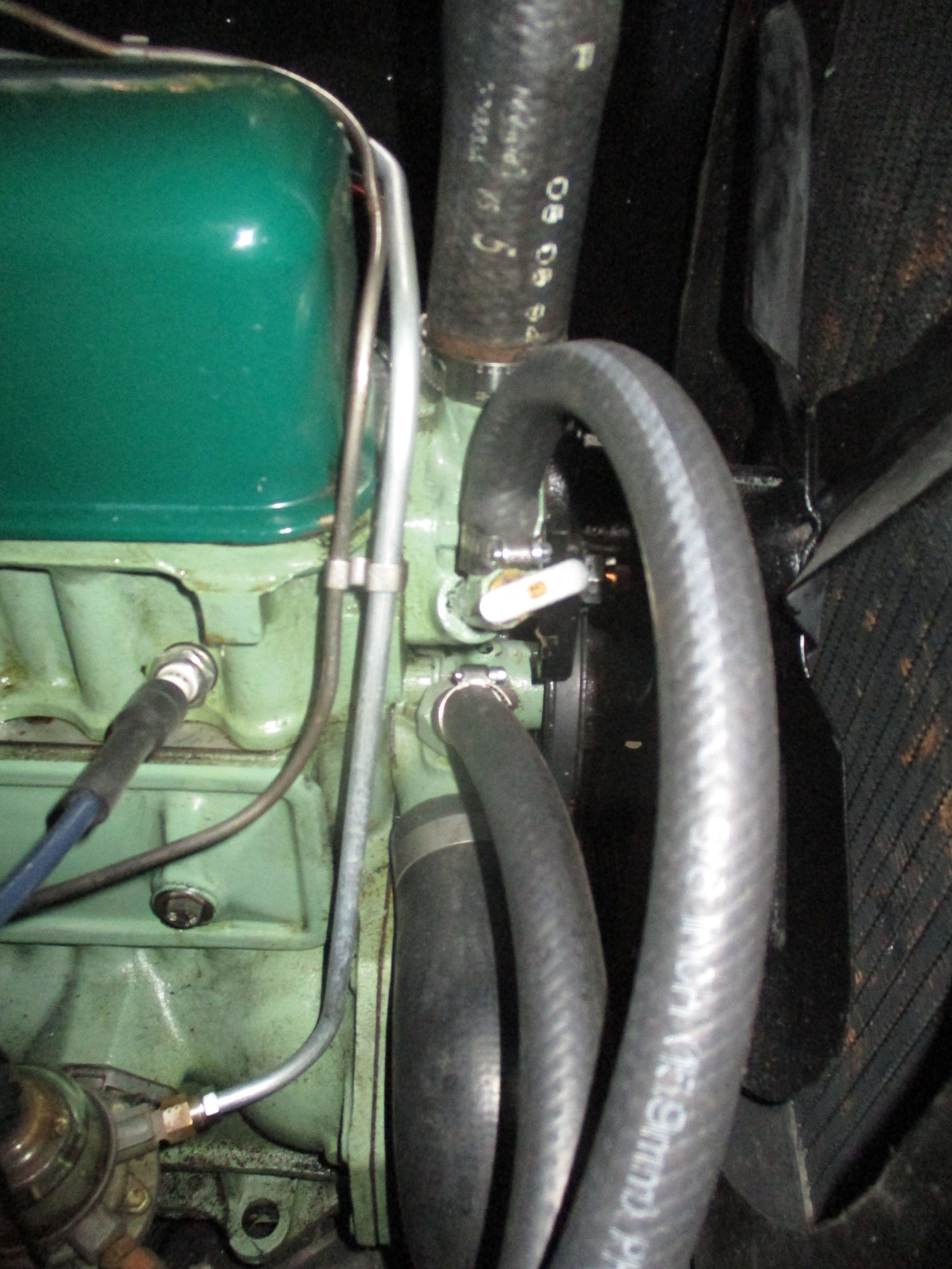

Do you still have your original valve? The rubber "washers" on the stem were shot on mine so I got a replacement valve. The replacement valve has the inlet and outlet at 90 degrees from each other. It worked fine when I was just running a short loop of hose back to the water pump like you have in your picture.
When I got a heater, I discovered the 90 degree replacement valve didn't work out so well for running hoses up to the heater and took another look at my original. The inlet and outlet are orientated about 130 degrees from each other on the original valve and work much better for routing your heater hoses along the inner fender. I took the original stem to a plumber, and he was able to find replacement "washers" for it. It works fine now. I'm sure glad I saved it. Good luck.

The hose going from the head to the heater core is the hot water intake, so that would be the line you want the valve in. Otherwise, the hot water will still be reaching the core through convection, and raising the temperature in the cab all year 'round, even if it isn't circulating. That hose goes to the bottom of the core so the water has to push uphill, which eliminates air pockets. This all allows a free flow back to the pump which draws the water through the heater and back to the engine, right along with the "cold" water from the lower radiator hose as you can see in Jim's picture above.
Typically, on the valve, there will be a direction of flow marked for proper operation.

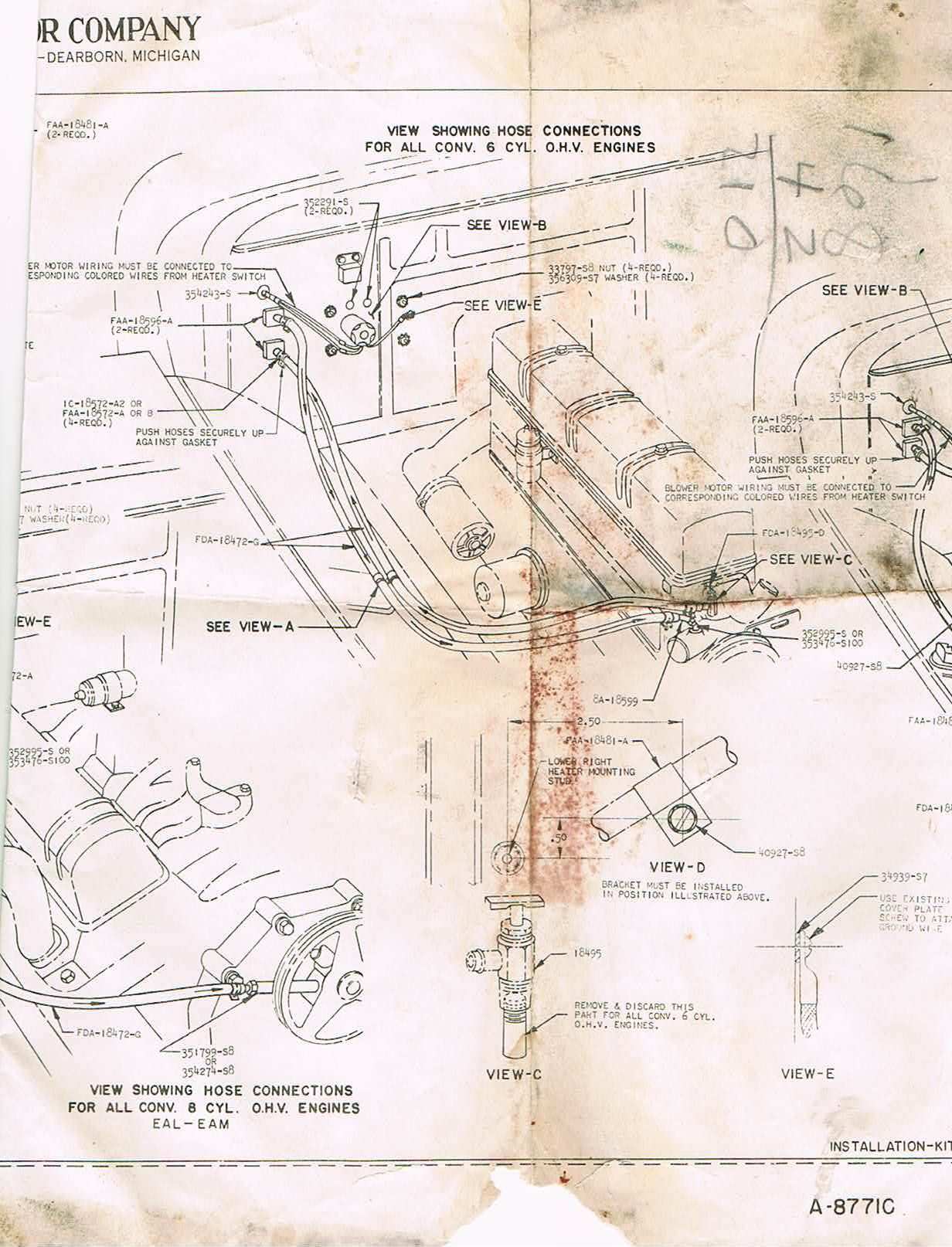

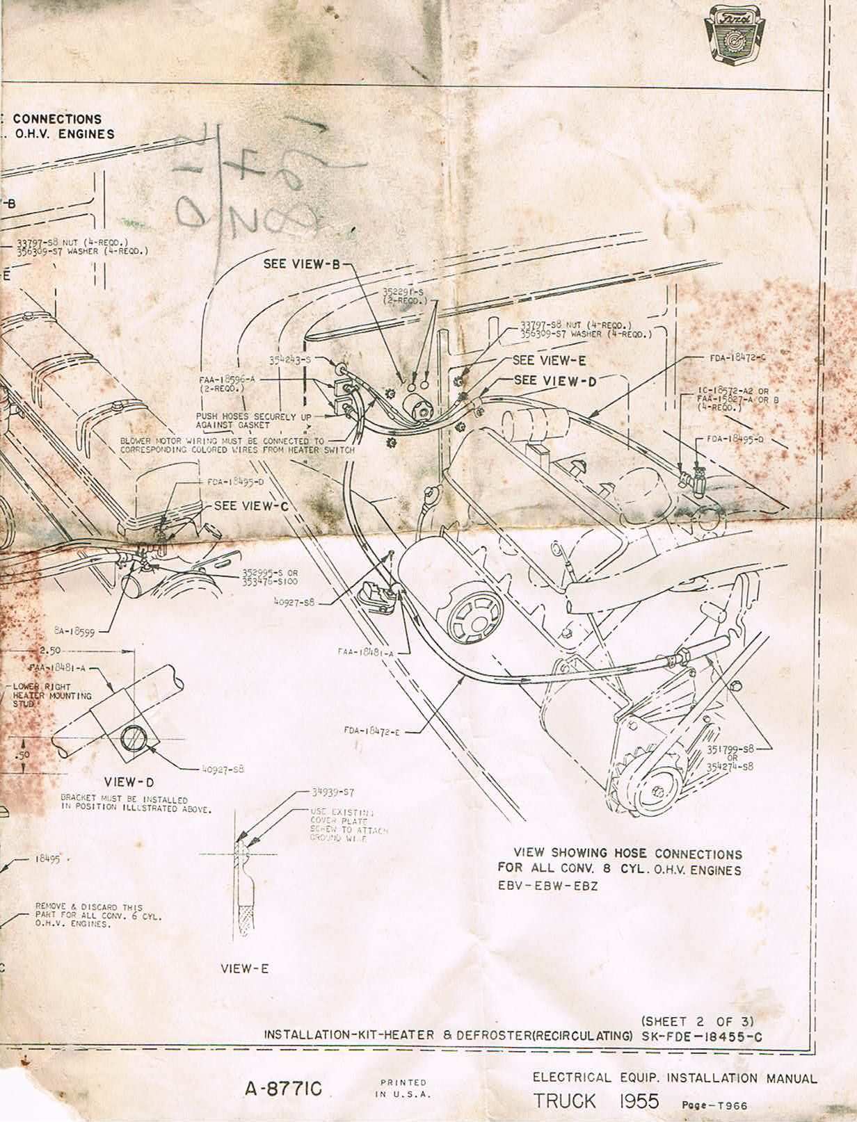

This might help you and others. I found this paper in the glove box of my 55 F350 when I bought it in 2016. It must have been in there ever since the dealer put in the heater!
whole page
close up of 6 cylinder
close up of 8 cylinder

Many Fords used this heater control valve, p/n C3UZ18495A (Motorcraft YG133)
Fits: 1961/72 F100/1100. Some big trucks thru 1991

Abe that original Ford drawing is helpful. Thanks for posting.
