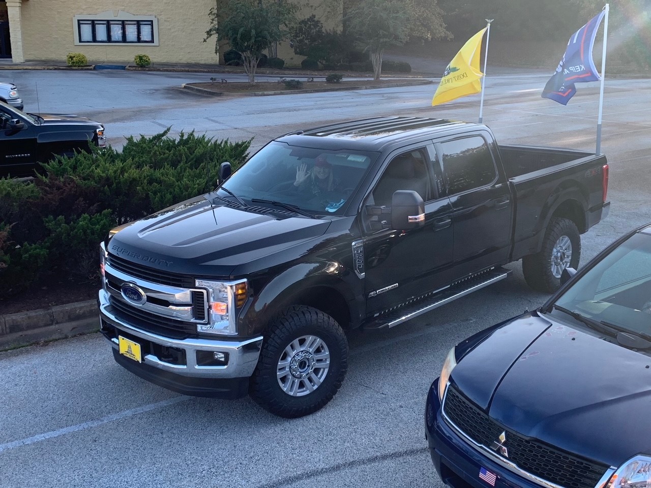

Old Mar 14, 2021 | 09:30 PM
Flyguy30263's Avatar
Flyguy30263
Joined: Jan 2020
Posts: 78
From: Newnan Georgia
2019 F250 OEM wheels and lowered rear using 2016 blocks, 35X12.5x18 with no rubbing anywhere.
Attachment 280235
