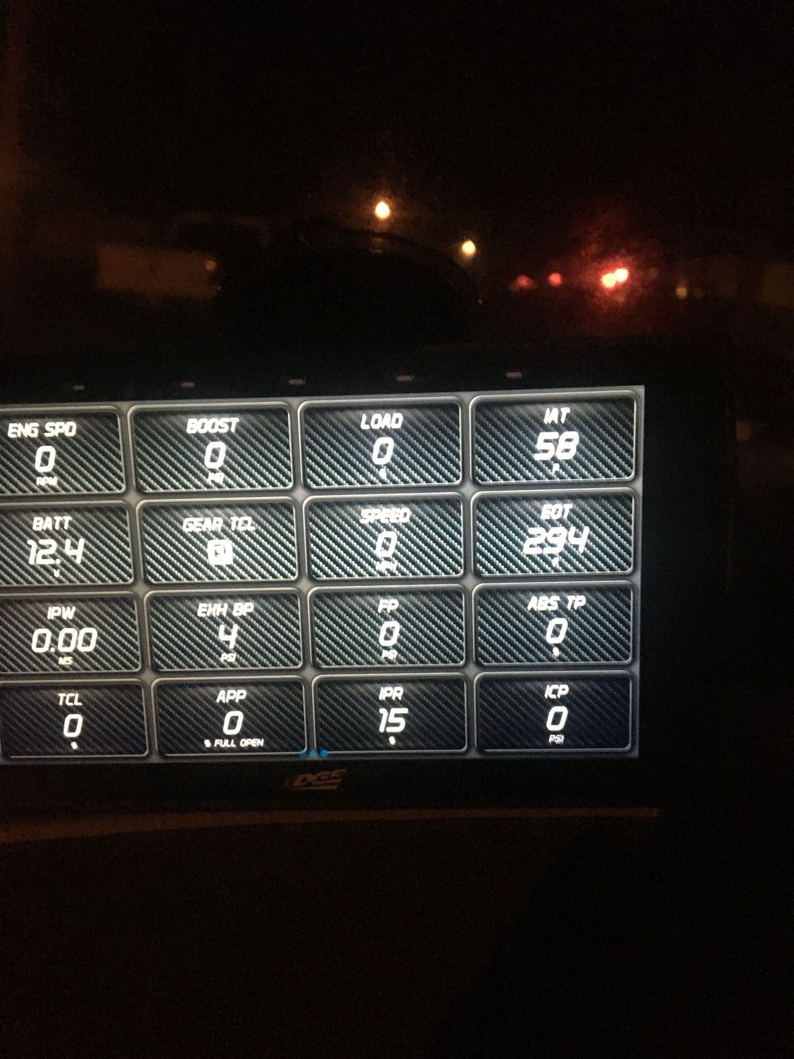

now that it’s been sitting for a few hours.I took this picture with the key on engine off.
this is what I set up on my edge, with no added sensors.
Old Mar 10, 2021 | 10:05 PM
JT20017.3's Avatar
JT20017.3
Joined: May 2020
Posts: 38
A you can see, the temperatures have changed drastically, so now I’m questioning it’s accuracy

There is no engine coolant temperature input into the PCM on automatic transmission trucks.
Therefore, the data from the Edge for ECT is garbage data.
