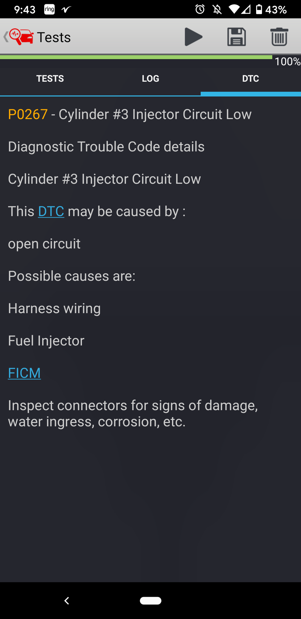

Ran the buzz test. I would say 1/2 of them had 1or 2 click sound. Others would make a soft clicking noise.
I did get this error message. I am going to check my connections. Would you start at the FICM (I did try just pushing on them with no success)?
Thanks,
Jerry
Old Mar 10, 2021 | 11:08 AM
bismic's Avatar
bismic
Joined: Nov 2003
Posts: 27,929
Likes: 3,651
Try hooking up the #3 injector connector to another injector and run the buzz test again. See if the code is still there or not (note - do not crank the engine).
Old Mar 10, 2021 | 11:42 AM
FJ Jerry's Avatar
FJ Jerry
Joined: Mar 2021
Posts: 12
The connector was actually just hanging there. Plugged it back in and ran the buzz test. Came up with no errors. Still doesn't start.
I only hear 6 injectors during the buzz test and about every other one has 2 slow clicks and the others have 2 quick back-to-back clicks.
Do you think that my injectors are gummed or connection issues?
