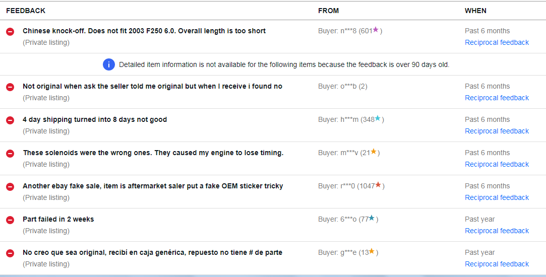

Old Mar 12, 2021 | 05:46 PM

Oh my god, even private listings! Knock Off
"ORIGINAL QUALITY" lol
