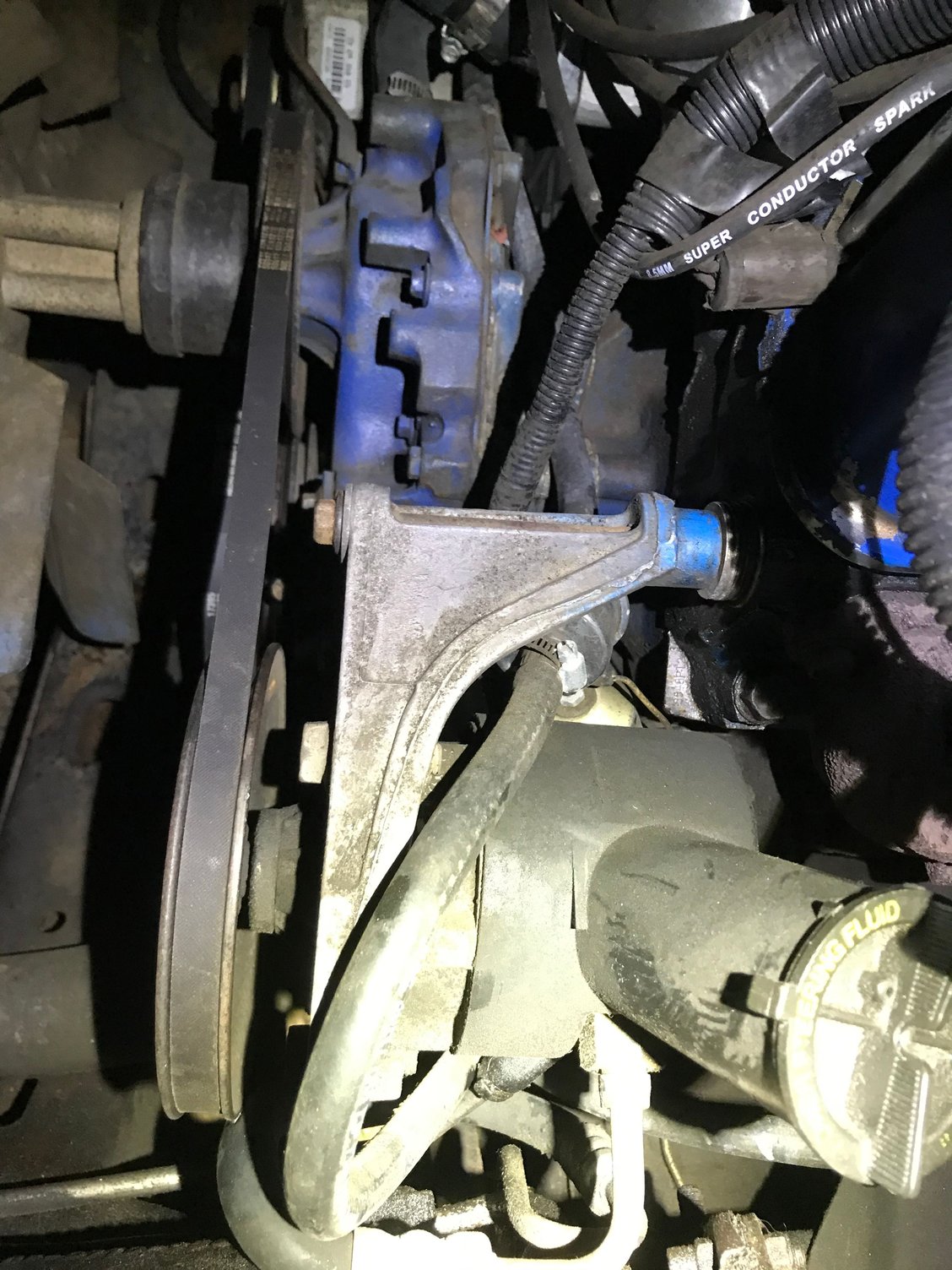

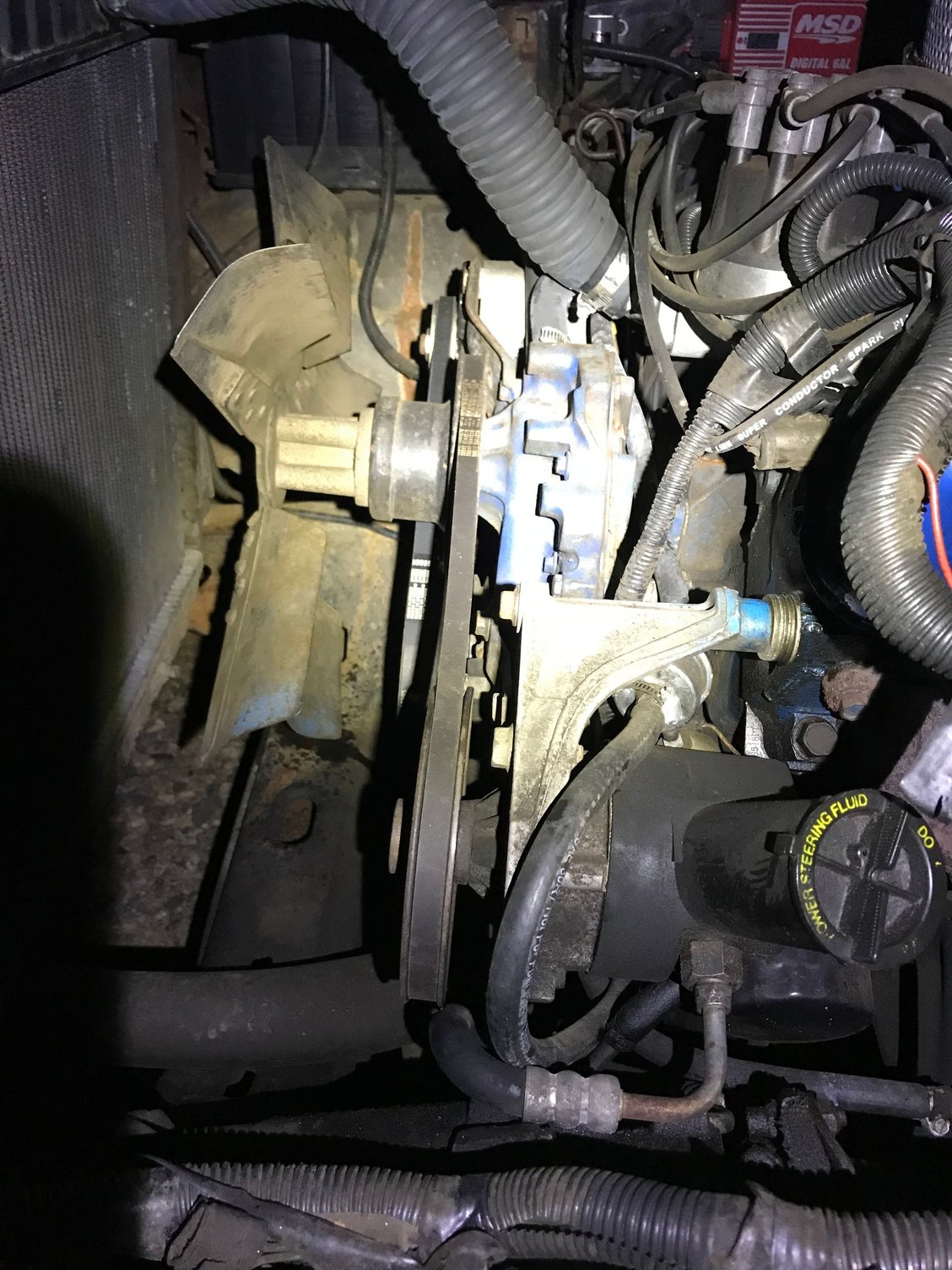

I’ll start with the checking the plugs and wires. The carb is running a little rich I will get that adjusted as well. The power steering pump pulley is not aligned with the other pulleys and the belt is squealing. I just ordered new parts for the bracket that are missing and will get it straightened out. This may be causing some vibration?
notice the washers and spacers on the bracket along with pulley rubbing the high pressure hose.

The misalignment could cause your belt noise but not a noticeable vibration .
If you're running rich the first thing to check is the choke.
