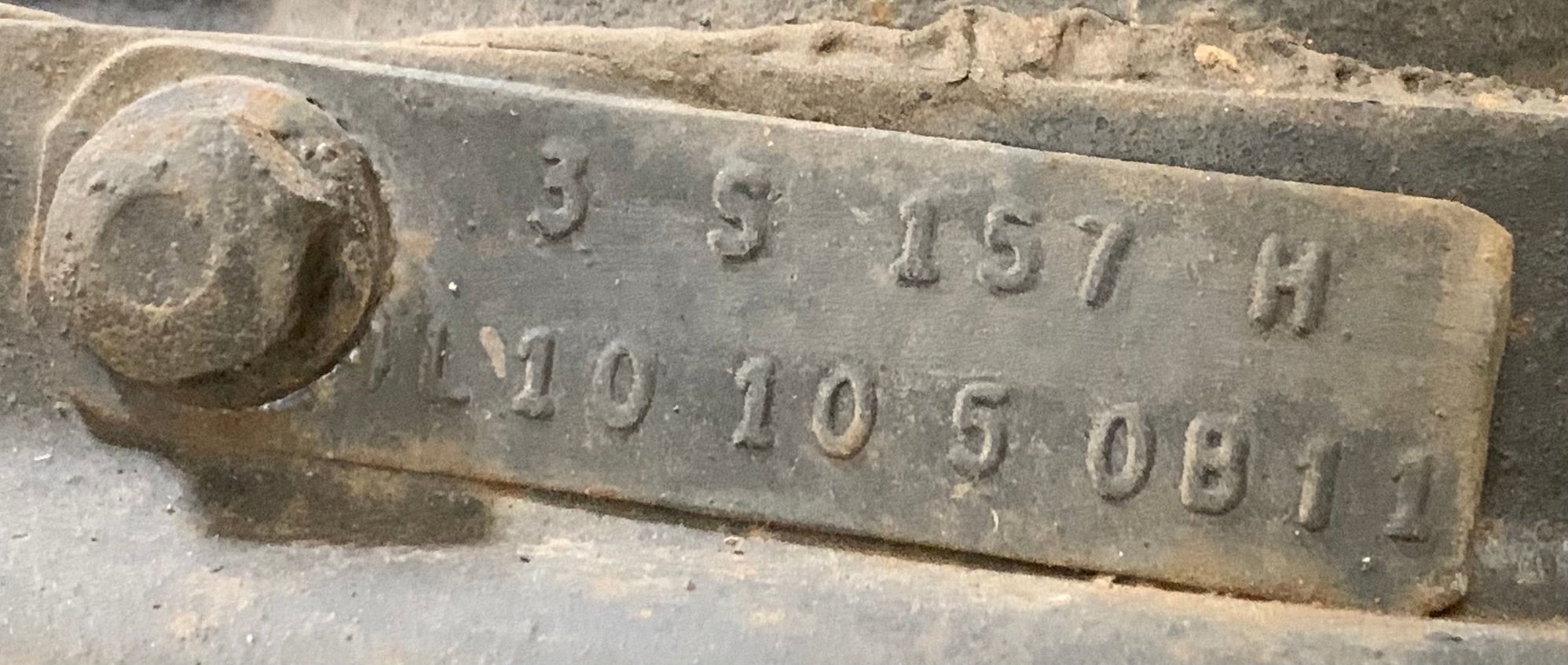

Hello I need a little help i am wanting to change out the gear oil and I’m not sure if I need the additive plus I’m curious what kind of rear end I have any info will be appreciated thanks and have a good day

You didn't give any info on your truck. Your profile indicates you have a 2000 F250. Most likely you have a 10.5" Sterling rear axle. What does your owner' manual say about adding the friction modifier? What does the 75w140 full synthetic gear lube bottle say? Or the manufacturer of the gear lube website?

Those tags look like a 4:10 geared 10.5. Either add friction modifier or buy a full synthetic lube with it already in it.

would it hurt if I put the modifier in even though I might not need it

On Page 34 of the of the Scheduled Maintenance Guide for your 2000 F250 it says this
if the axle was filled with 75W140 synthetic gear lubricant meeting Ford specification WSL-M2C192-A, part number F1TZ-19580-B or equivalent. Add four ounces of additive friction modifier C8AZ-19B546-A (EST-M2C118-A) or equivalent for complete refill of Traction-Lok rear axles. The rear axle lubricant should be changed anytime the axle has been submerged in water.

You need to look at the door tag at the axle ID number to tell you if it's a Positrac, this is the only axle that needs the friction modifier. The standard or open differential does not need the modifier, can you add it, sure won't hurt a thing but why spend money if you don't need to.

If you look at the photo of the tag he posted, it tells you it is a 4L10, i.e., 4.10 limited slip rear end. No need to check the door.
If it were an open rear end, it would have been 4.10 on the tag.
