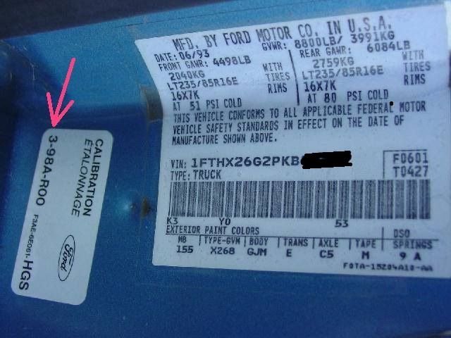

Is the calibration sticker still on the driver’s door “B” pillar?
“Borrowed” picture.
“Borrowed” picture.
Yes, it is. Thank you for the helpful pic so it is obvious even to me!
In case you were going to ask, the numbers are
8-51F-R00
E8AE-6E061-ACR.

8-51F-R00
E8AE-6E061-ACR.
A truck with a calibration number of 8-51F-R00 needs computer (ECU) number E8TZ 12A650-XB.
