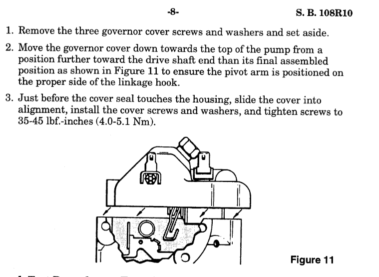

so I actually just got off the phone with them, they were very helpful and said that I can take the top cover off and inspect the metering valve and such and it will not void my warranty. I’ll check that when I get the chance and I’ll also look into the link you posted

I'll give you this on how to put the cover back on.
IF the cover is installed wrong it will cause problems.... it comes off real easy.. and if ya watch the Video of "Be the Fuel" you should have an understanding of what is going on.
I'm sure there are plenty of other boobtube videos on the subject ...BUT you don't want to "Adjust " anything you just want to make sure the Metering valve is free and not sticking...you do not need to disassemble anything other than the 3 screws that hold the cover on. A Torque screwdriver such as Utica torque limiter is real handy. or any Quality 1/4 drive torque wrench that meets the range requirements.

Okay, thank you so much I really appreciate all the help and support. I’ll get to it as soon as I can and report back if I’m able to get it going. This is kind of a dumb question, but what If i try and start it off of ether to see if it running will help get fuel from the pump?
