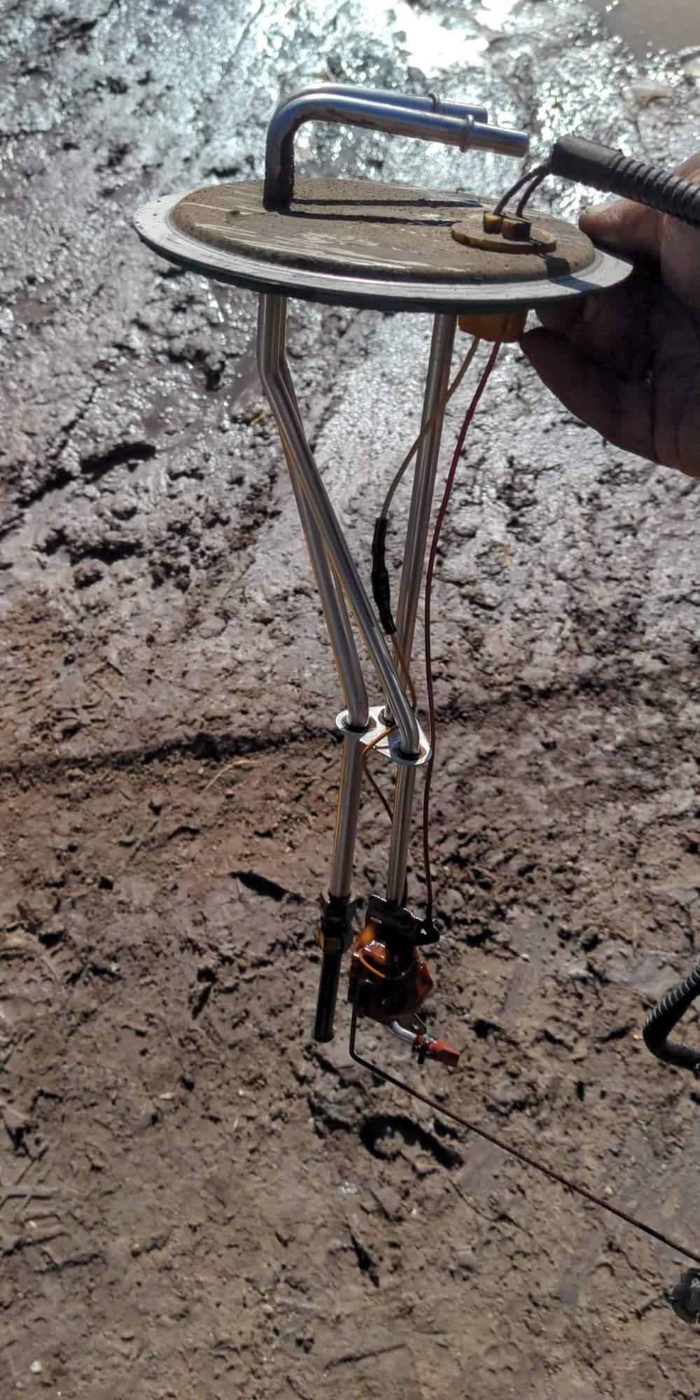

Old Feb 25, 2021 | 09:40 AM
  #44
Dequinex's Avatar
Dequinex
Joined: Mar 2020
Posts: 33
From: Downriver Area - Michigan
That's how she came out
Old Feb 25, 2021 | 09:47 AM
  #45
AllaboutMPG's Avatar
AllaboutMPG
Joined: Oct 2011
Posts: 3,953
Likes: 120
From: Mcdonough, GA
What the heck???? And you have no inline filter / screen?
