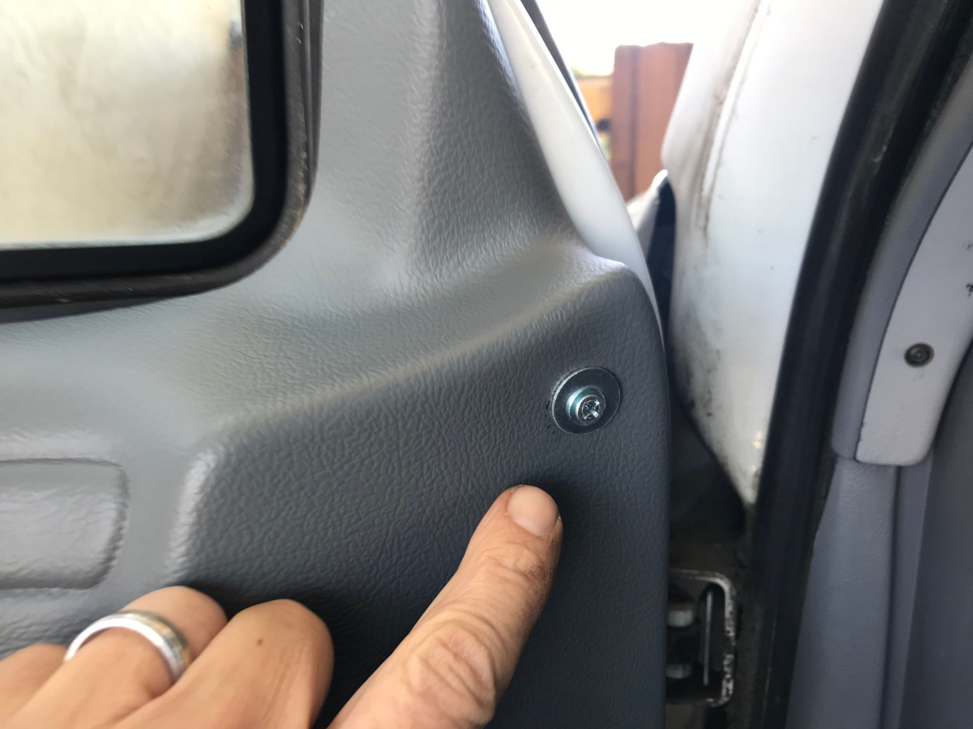

Okay, lucked out on the Medium Gray panels. Got them into the truck, pretty easy install. I did the CP Addict door panel reinforcements first, then put in metal door handles. The only issue with the panels was the screw in the upper part of the panel near the wing window was to short and the plastic broke out. I grabbed a longer screw and added a couple of washer on each side, worked perfect! Truck rattles have pretty much gone away!

Okay, you know the saying, we need pics or it never happened.

Attached.
Sorry if the pictures aren't perfect.
Old Mar 22, 2021 | 12:06 PM
wharthog's Avatar
wharthog
Joined: Feb 2008
Posts: 516
From: Michigan
Very nice looking. Thanks for the pic. Now I think I will be shopping for some.
