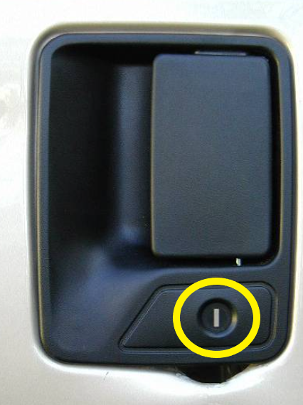

Rob, did you spray some lubricant directly into the key hole cylinder? That is what I did when my locks were stiff/frozen due to lack of use.
Just so there is no confusion, I have included an image with the focus point circled in yellow.

Yes, that part is not the problem, it's exactly the same on both doors, the key turns freely in both directions, with more resistance in the unlock direction. I'm going to have a good look through the FSM & see if there's a good schematic of all the linkages.
