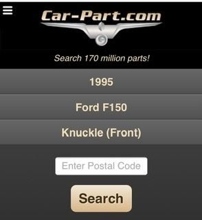

Have you looked here?
Old Feb 11, 2021 | 09:42 AM
Old green123's Avatar
Old green123
Joined: Mar 2020
Posts: 57
I did. And then called the closest five places that listed one. They either didn’t have it, didn’t answer the phone, or were supposed to call me back to confirm, and didn’t. I bought one on eBay, should be here in a few days.
