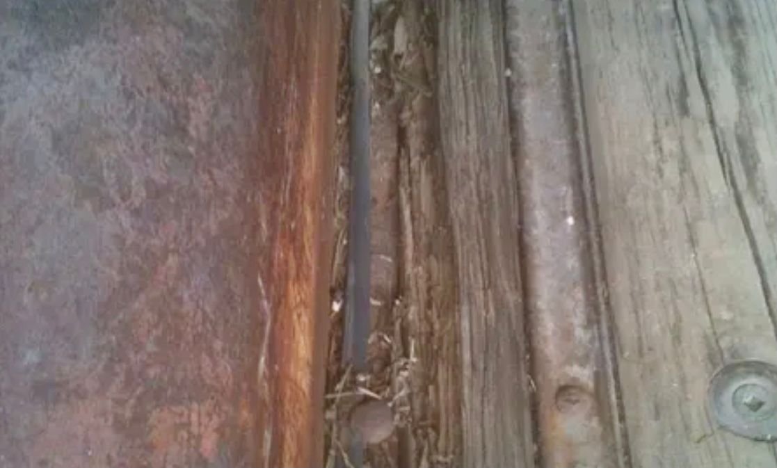

Yeah, my 2wd AZ truck that I intended to be a parts truck, but have never had the heart to pull apart, is sort of a time machine. It has this rope seal along the edges under the wood. Stu

It looks more like anti-squeek welting than a hermetic seal.

Interesting. Since the same style and material seem to be used on them, it would make you think that it is a factory and not a user added item. Can anyone take some detailed photos and measurements?
Is it rubber or fabric? Does it go around the entire box?

My two pics are of the same section from different angles. That’s the most clearly seen area where the wood is fractured away from the bed wall. It well could be that the rope is more intended as an anti-squeak or anti-abrasion aid rather than water seal. I don’t know whether it is a hollow tube or (now dead) foam type rope. I have no doubt that this is an original 1951 installation at the KC assembly plant. As a practical matter I’d think anything of similar dimensions would do the job, as long as it is collapsible under the edge of the wood. When I get there on mine I’ll probably see what McMaster Carr offers in a hollow rubber tube type material. Stu

Thanks Stu! Is is just a round tube, or is it a bubble kerf seal with the tail?
Anything on this website that looks close? From the photos, something along these lines were my best guess at the moment, assuming it it has a tail to push into the seam.

I’m not gonna be able to pull a piece of the original to study it. The bed of the truck is loaded full of pieces from other trucks. The tube that you found looks like it’d work well. Stu
