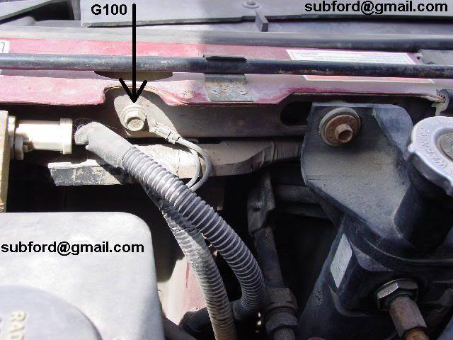

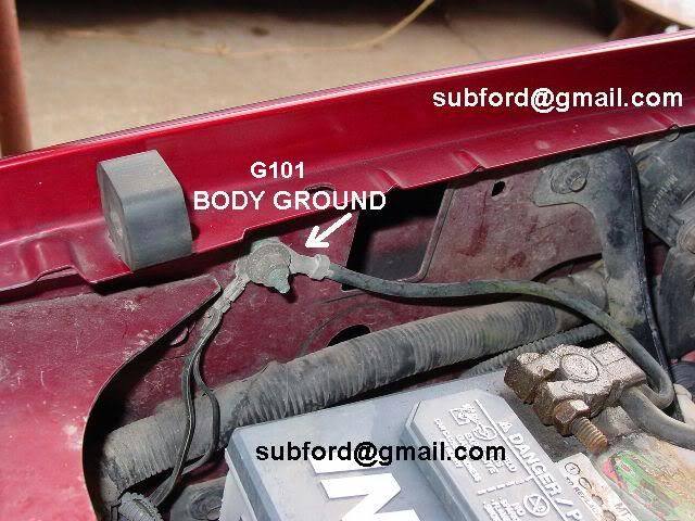

Also remove and clean up the grounds for G100 and G101. Both are used for the turn/stop/hazard lamps.
The ground point is the drivers radiator support, G100.
G101

Thanks so much RLA! Sounds like those ground points are probably the culprit... I had the whole front end of the truck torn apart at the end of 2018 to do a motor swap, and those ground points were undone then, so they probably just didn't get cleaned up when we put it back together...
