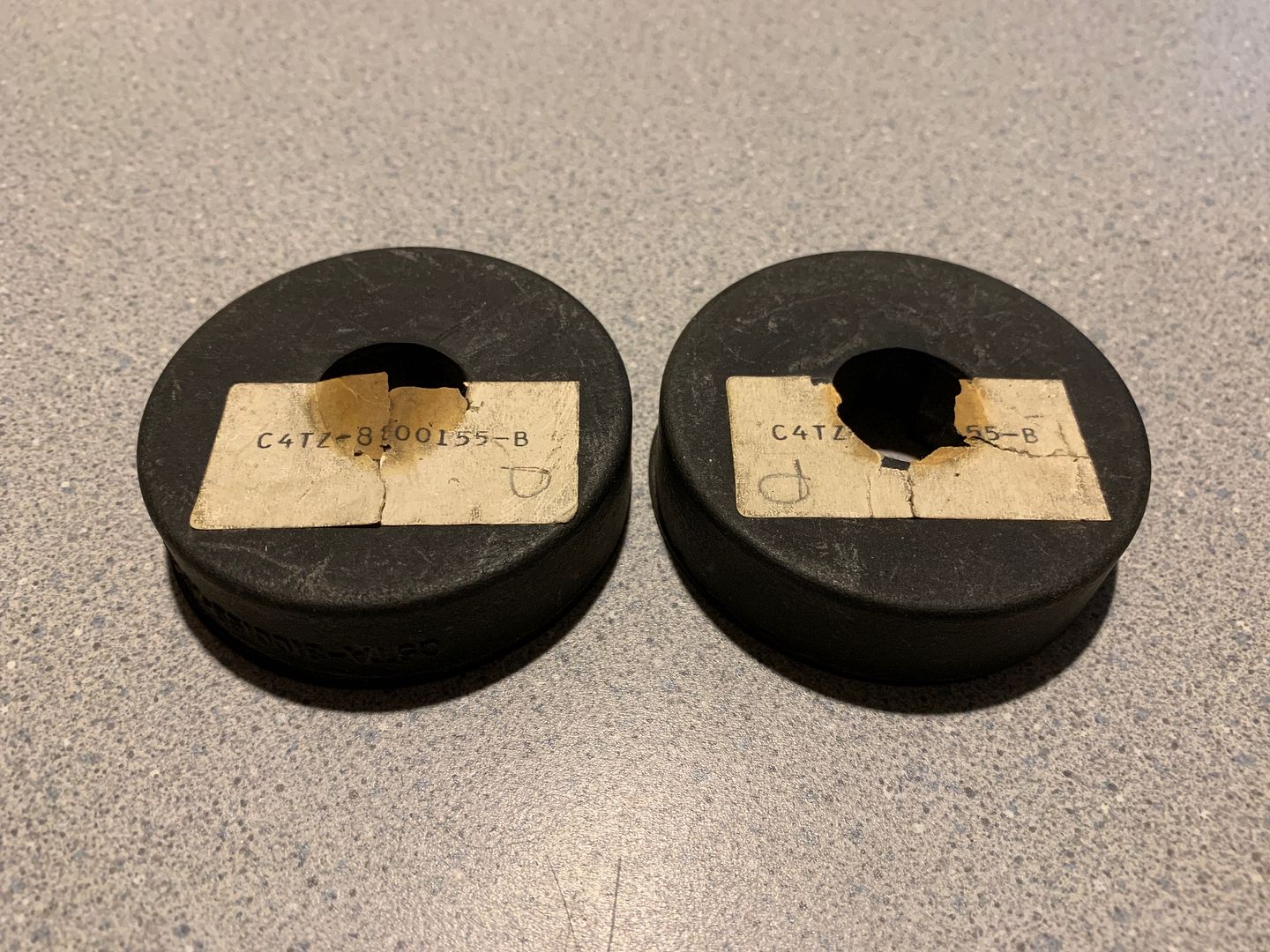

Here's some NOS lower radiator support bolt absorbers. These measure 11/16" thick as do the uppers. 1 7/16" for the sleeve height is same as 23/16" - and 11/16" times 2 bushings is 22/16" plus the thickness of the frame rail at a solid 3/16"+ for my frame gives about 1/8" compress space or about 1/16" per bushing.
