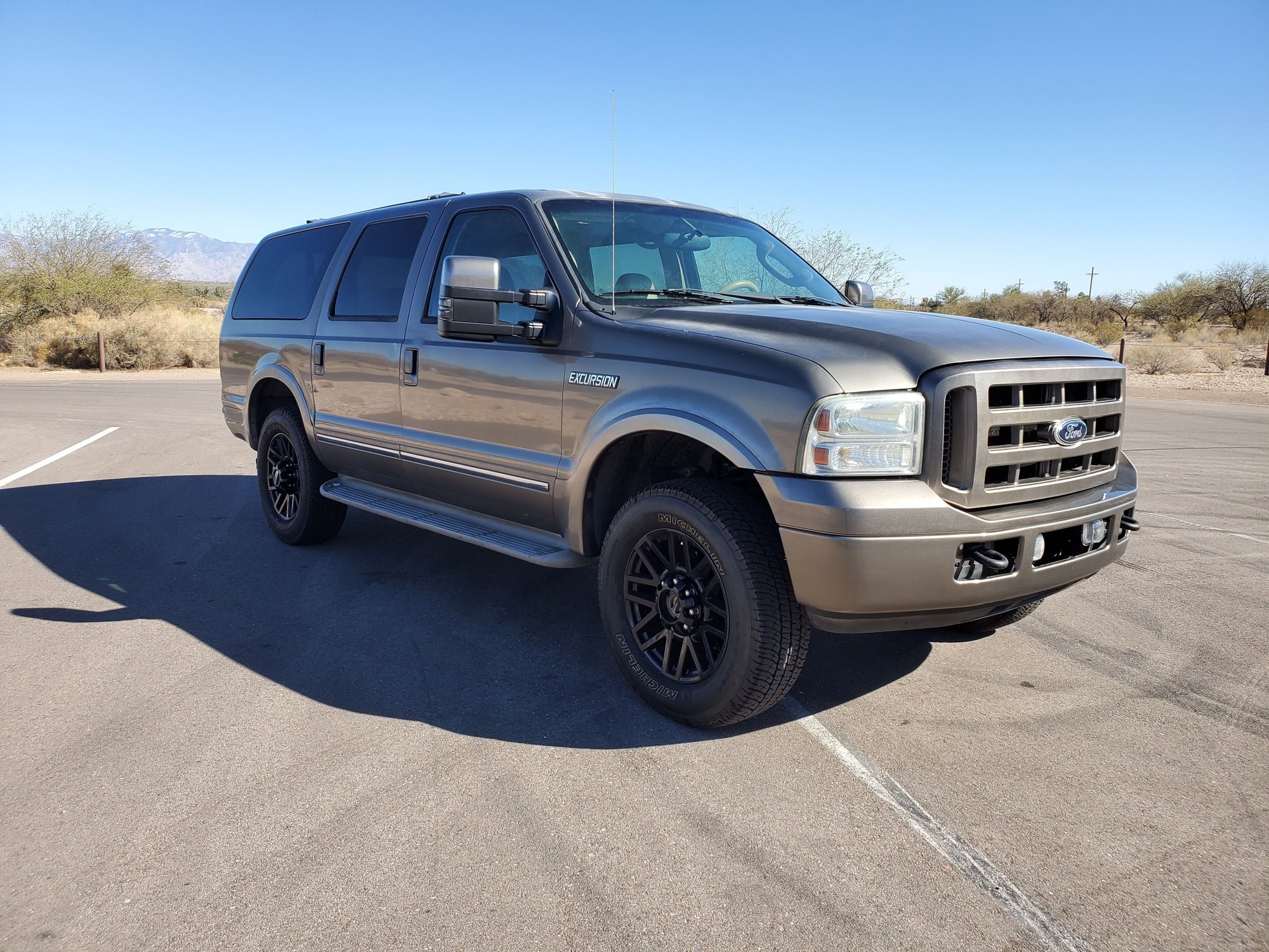

Excursion 06 Axle & Coil Swap Build
Looking for experienced feedback for my build …
Using a 06 F-250 6.0 roller for both axles and front suspension
My goals
1) Minimal lift (2-3”) so wife and grandkids can get in. If possible…
2) Using OEM F-250 18” wheels with 35” tires
3) 10k Tow capacity for toy hauler
4) Smoother ride on gravel roads and the rough Pennsylvania pothole roads.
Current plan is to:
1) New OEM front spring buckets
2) PMF control arm brackets
3) 99-04 Mod B rear leaf springs
4) Fox correct valve shocks
5) PMF adjustable track bar
6) Reinstall the air bags that are on now.
7) Later re-gear to 4:88
My questions:
1) Are the stock f-250 6.0 coil springs the correct spring rate
2) How much lift will I get with coil swap
3) Who / where to purchase correct fox shocks to use
4) Should I use the 06 steering gearbox
5) Any benefit using a different leaf springs to avoid with using blocks
6) Use stock or drop PMF control arm brackets
7)
Alignment specs to use
Thanks in advance for feedback …
