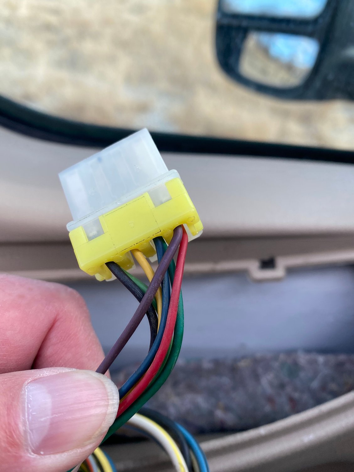

hi there, I’m just curious how the mirrors can be tested. I’ve heard with (jumper wires)? Is something you could describe to me so that I can try it? I have power to the switch itself, but the nothing at the directional contacts on the plug🤦🏼‍♀️
maybe this will help me determine whether or not the mirrors are still working. At least I’ll feel like I’m making progress🤣

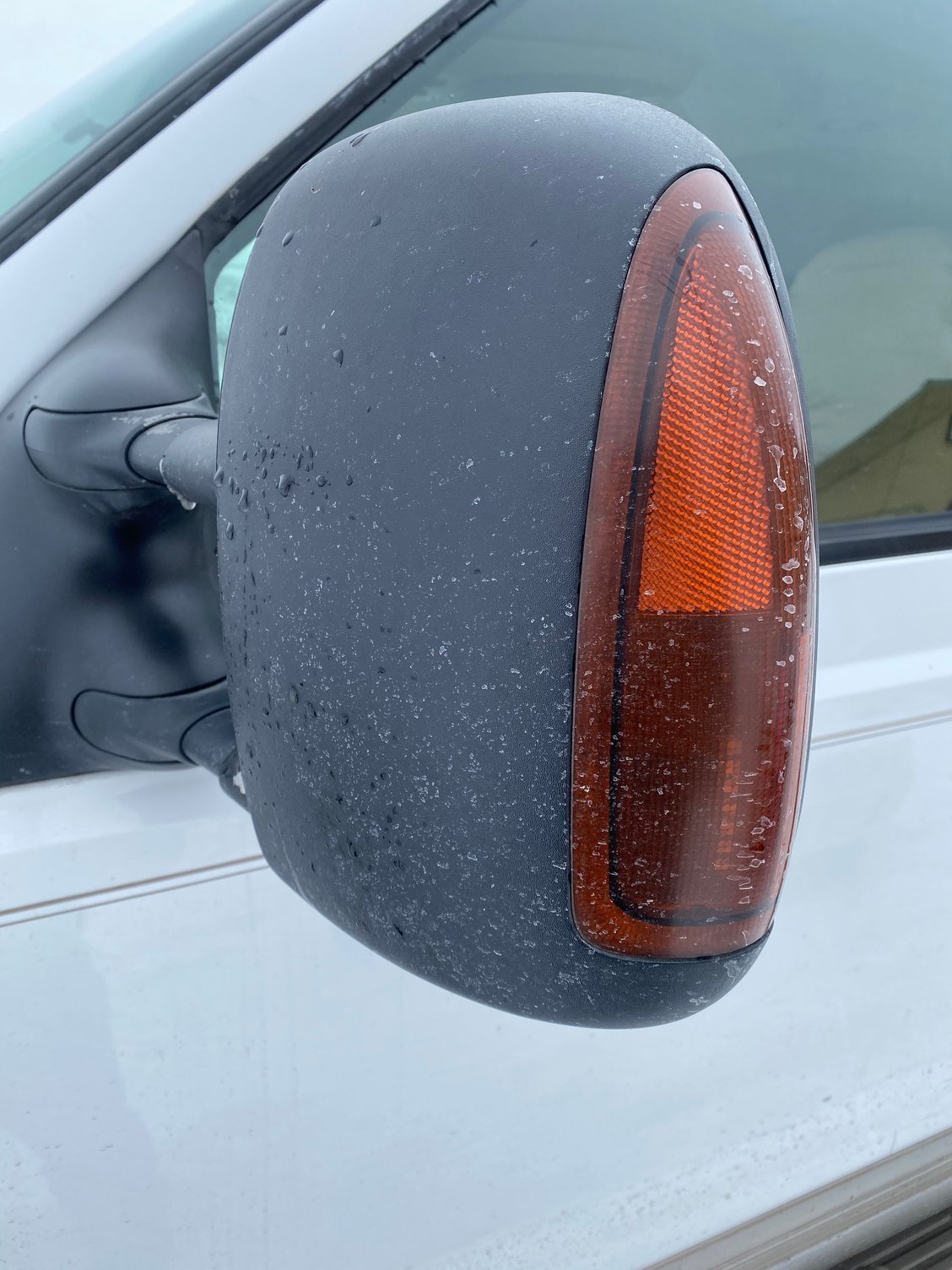

Driver’s side mirror
Plug to mirror switch

How about a picture of the mirrors and also the wire harness to assist us in pointing you in the right direction.

Those mirrors were not available on the 01 model, the PO must have installed them and failed to run any wires to power them. Does the mirror adjust; or is the mirror not plugged into anything? I believe that style mirror were available on the 03 and newer 250’s I do not know if they were ever available on our Ex’s . You will have to wire them yourself. There is some info on how to do it in the sticky thread above.
