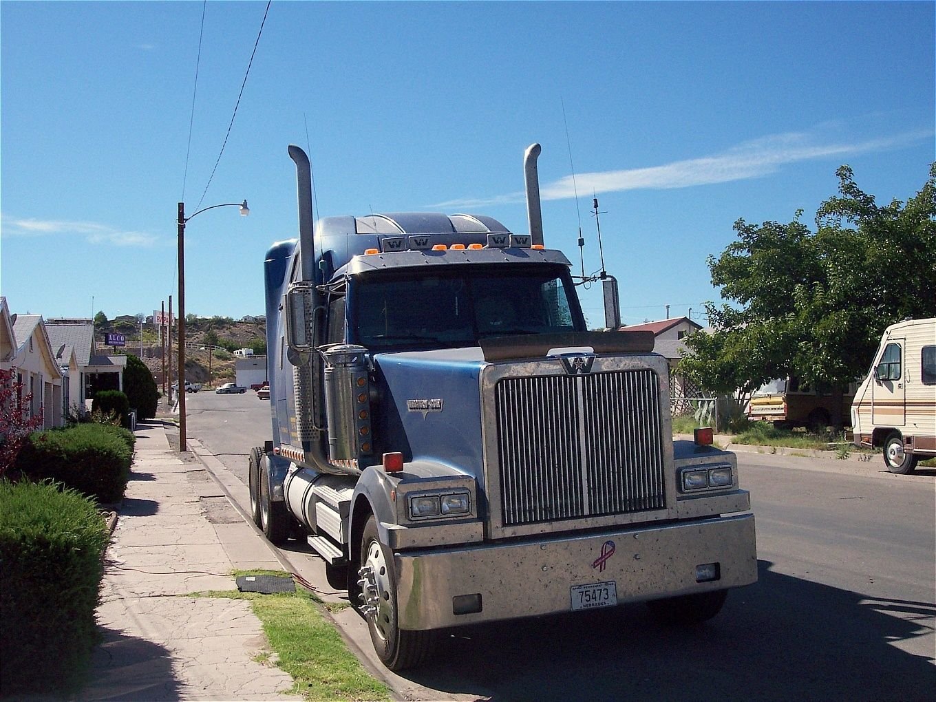

Why CDL? Because you will spend 8 hours a day practice, practice, practicing. I actually hired onto a company & drove their truck for a year, then got really stupid and bought one. About 100,00 in their truck and 750,000 in mine. (10-12K a month) Made some money and gained confidence I can put the 36ft 5W any where I want it. Your right practice does make a differance just not many will spend 8hrs a couple days to learn and I will guarantee the class will be far more structured. I know after pushing 75ft of truck that many miles not much will worry you about where you can park. I've been to CG's that tell me all they a have left are back in's and some when told will leave. Did you know many back in sites are less money because they use less space? The class may not be for everyone but I'm sure it will be cheaper than adding all the backup BS to a truck. Simply GOAL then back in.
