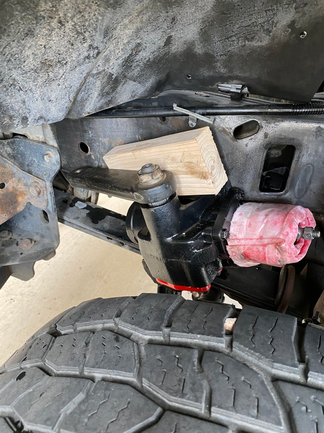

I ran into the issue of my vise not being big enough and bench not strong enough to torque the pitman arm nut to 199 lb ft. I decided to bolt the redhead on the outside of the frame using 2 bolts and that allowed me torque the pitman arm appropriately.
Maybe this will help someone else in the future.

Nice tip and it looks like someone stole all the rust off of your truck.

That is a good idea and I will more than likely use that technique when it comes time for a Redhead or Bluetop to go into my truck.

Almost time to paint the frame!
