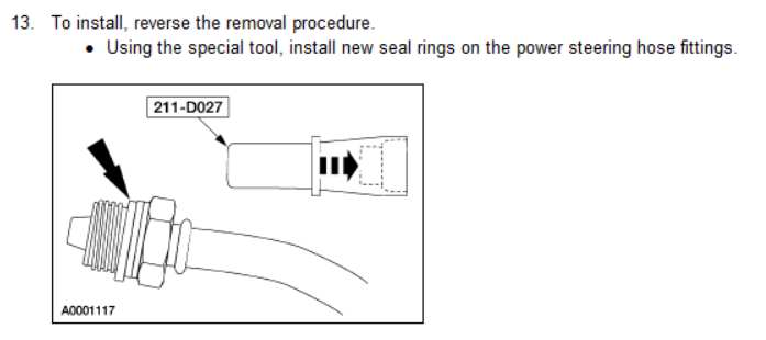

Your not referring to the teflon washer (Dorman 82540) are you? They go between the hose and the gear on both sides and are two different sizes. I replaced the high pressure hose with a Motorcraft from Riffraff 3ish years ago and do not remember an o-ring, but I have slept since then so my memory has been wiped.
EDIT: Looking a bit further into the missing (in my brain) o-ring on the hoses, I found this in section 211-02 in the FSM and I believe it is referring to the teflon washers as well. Still looking for the o-ring part.

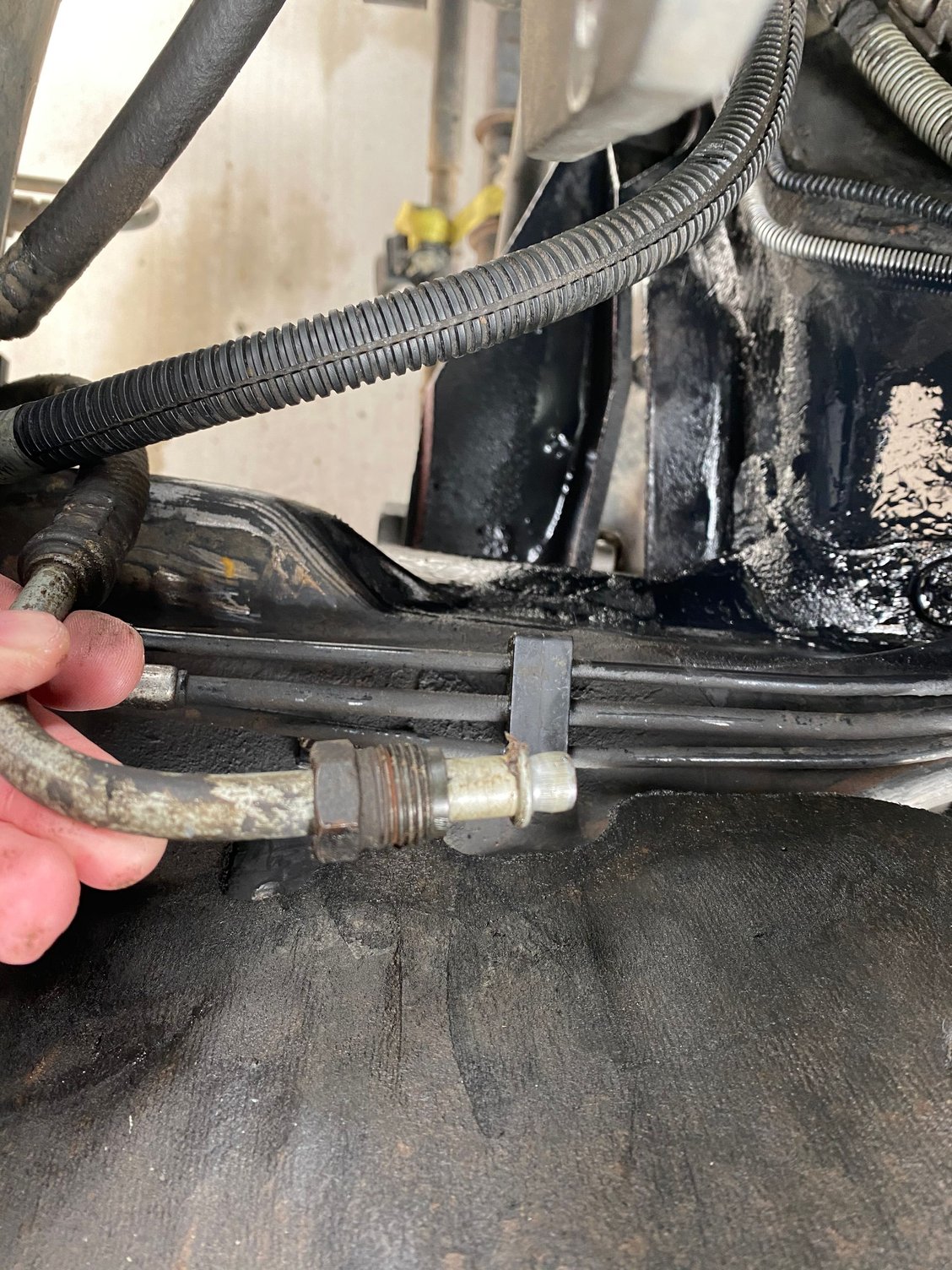

When I disconnected this from the steering gear there was only 1 o-ring on it, to the right of the ridge. This is the return line from the cooler to the steering gear. The current one was black.

No problem at all. Just so we are clear, you are looking for o-rings to go on the lines where the lines connect to the steering gear with the sliding fitting, is that right?
Old Jan 24, 2021 | 10:46 PM
ztodd377's Avatar
ztodd377
Joined: Mar 2007
Posts: 898
Likes: 23
From: Tucson
There’s two hoses into the steering gears. One is a pressure hose from the hydroboost (there’s also a pressure hose from the hydroboost to the PS pump) and the other is a return hose from the cooler to the steering gears. The second one is the one I’m looking for o-ring for. Akcoopers thread helped a lot. I think a rubber one will be the ticket, just need to measure the tube once it stops raining.

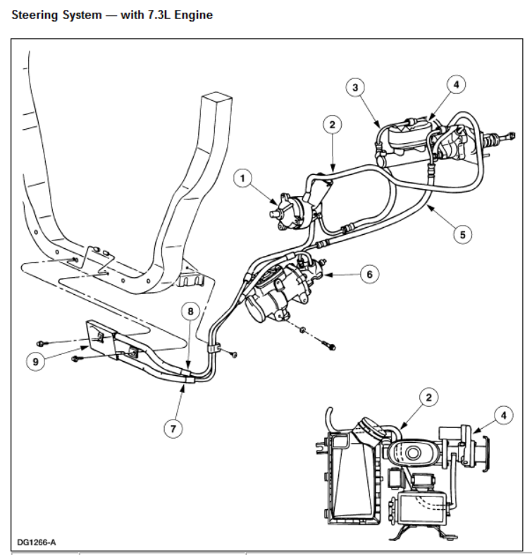

Pictures are worth a 1,000 words... Your looking for o-rings to fit on hose number 5 and 7 at the steering gear which is number 6, correct?
Old Jan 26, 2021 | 09:02 AM
ztodd377's Avatar
ztodd377
Joined: Mar 2007
Posts: 898
Likes: 23
From: Tucson
Just the one for hose number 7. I have a new hose number 5 coming today. Received my Redhead yesterday. She was waiting patiently on my doorstep. The new gears do indeed come with new o-rings in the package! Thanks to everyone for helping with this.
