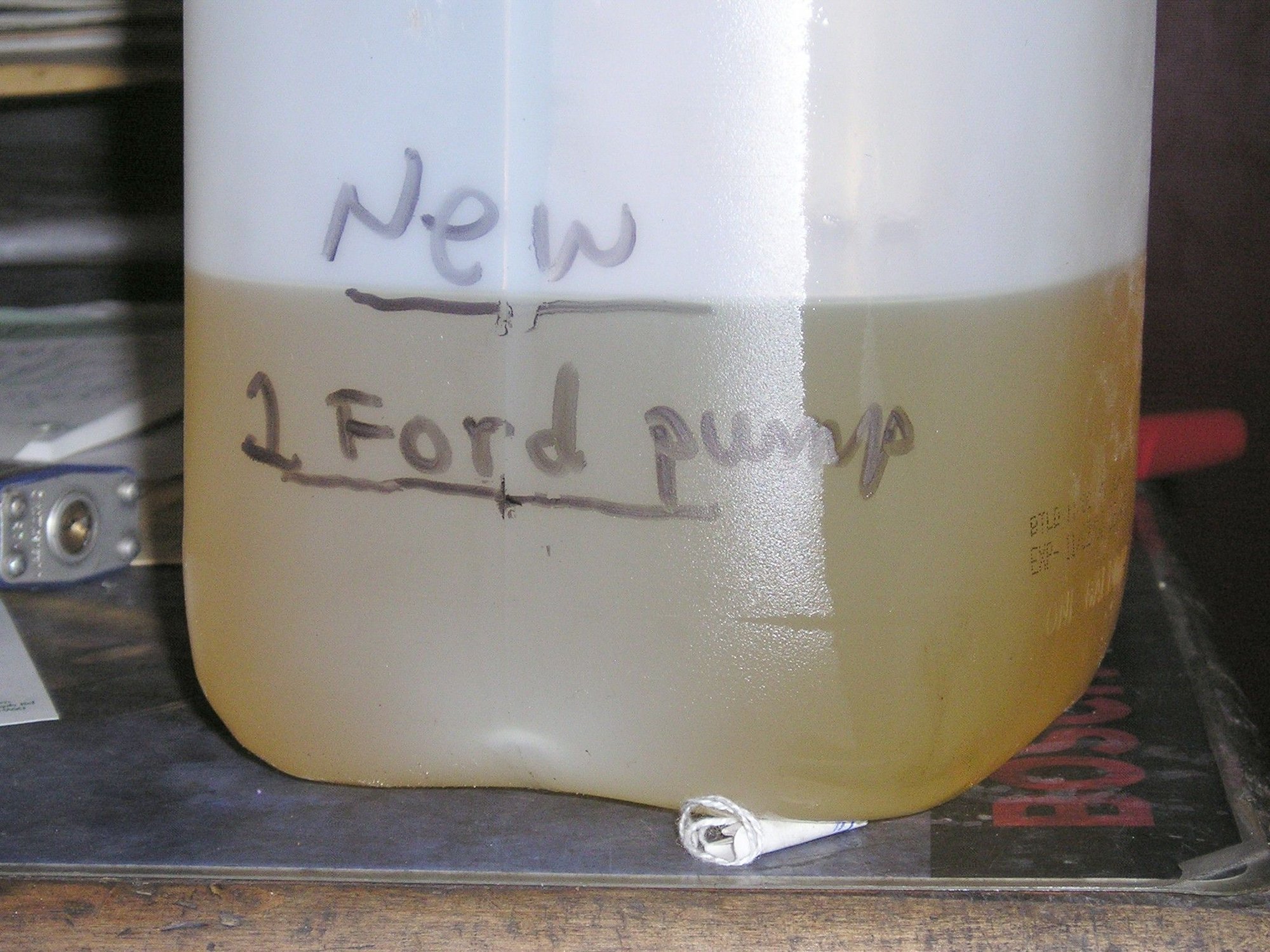

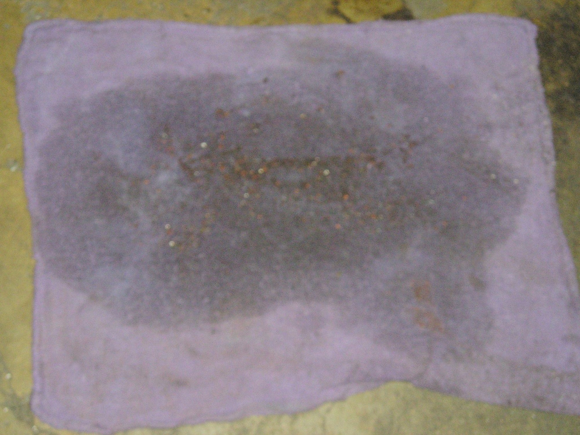

Two more pictures. One shows a partial amount of all the junk that came out of the fuel pump inlet on the factory Ford design, and the other one, that compares the flow rate of the stock Ford pump vs the Bosch pump. Same time interval. Significantly different amounts of fuel delivered. I'll agree that the Ford pump was already strangled by whatever leftover debris may have been stuck inside the housing in that built in screen that they thought was a good idea to put in there.

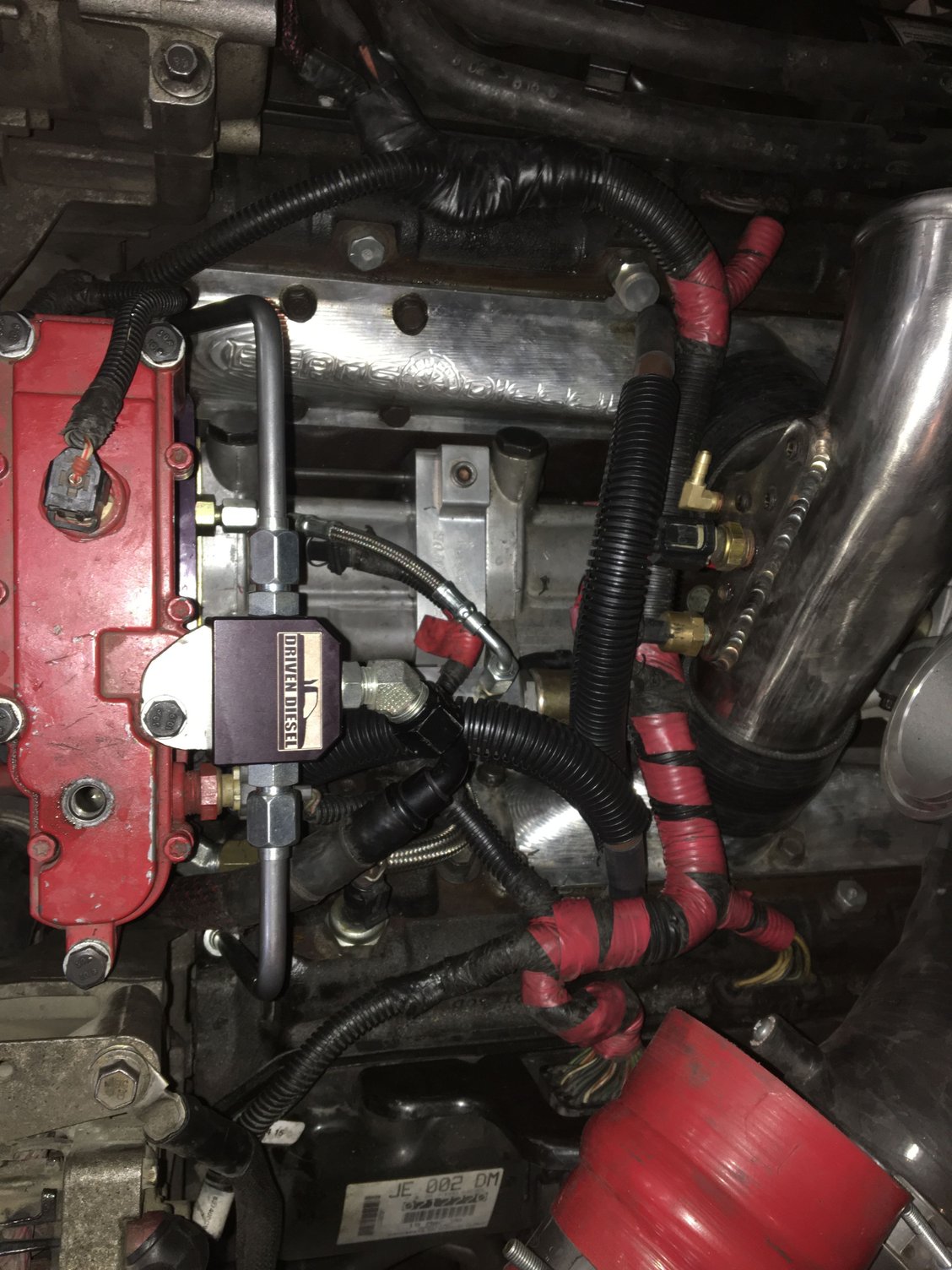

All of this discussion has me wondering about the approach of deleting the stock fuel bowl, adding a (2) line fuel manifold block that collects the single supply line and splits it to the two front of head ports (Nothing feeding the back ports) Supply would come from an Air DogII5G. With this approach you keep the origional supply scheme at the heads, but get the added benefit of having a regulator at the Air Dog for pressure with the return of excess fuel right from the Air Dog back to the tank. (2 line regulated return). You also get the benefit of freeing up space in the engine valley by removing the fuel bowl and in my opinion filter changes are easier and you can get 2 Micron filtration vs the motorcraft 10 micron.
Thoughts?

Two actually, the front fuel rail port on the passenger head is a Mother Trucker, due to the hpop reservoir setting nearly on top of it. Second is the use of the front ports all together. Setting on relatively flat ground the driveline slopes slightly rearward, which would make the front ports somewhat of an air trap. Diesel fuel inherently forms tiny bubbles that travel along everywhere it goes. So every time the engine is shut down those bubbles will collect and leave an air pocket. With nowhere to go but forced through the injection system it will likely give some idle hiccups till worked through.
Side note: What is the obsession w/ ultra fine micron filter ratings? I understand we want clean fuel and all but seriously do we know how tiny even 10 micron is? It's 0.00039 of an inch. That is 10x smaller than a human hair, not 0.010, 10 times as in a whole decimal point. We're talking microscopic here. Is anything but the fuel pump really going to notice the difference between 10 micron and 2 micron filtered fuel?
