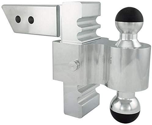

I use an Andersen Rapid hitch that fits a 2-1/2” receiver. I have the 6” drop and rise version. At times I use all 6” drop on my 2020 F350 CCSB.I’m very satisfied with it.
Amazon Amazon
My friend had his stolen off his truck so I bought the Andersen keyed locking pins that I use all the time.
Amazon Amazon

Here's what I use on a trailer that I pull almost every day for 6-7 months of the year: https://shockerhitch.com/products/sh...eceiver-hitch/
I've got 5 trailers so adjustable is a must for me.
