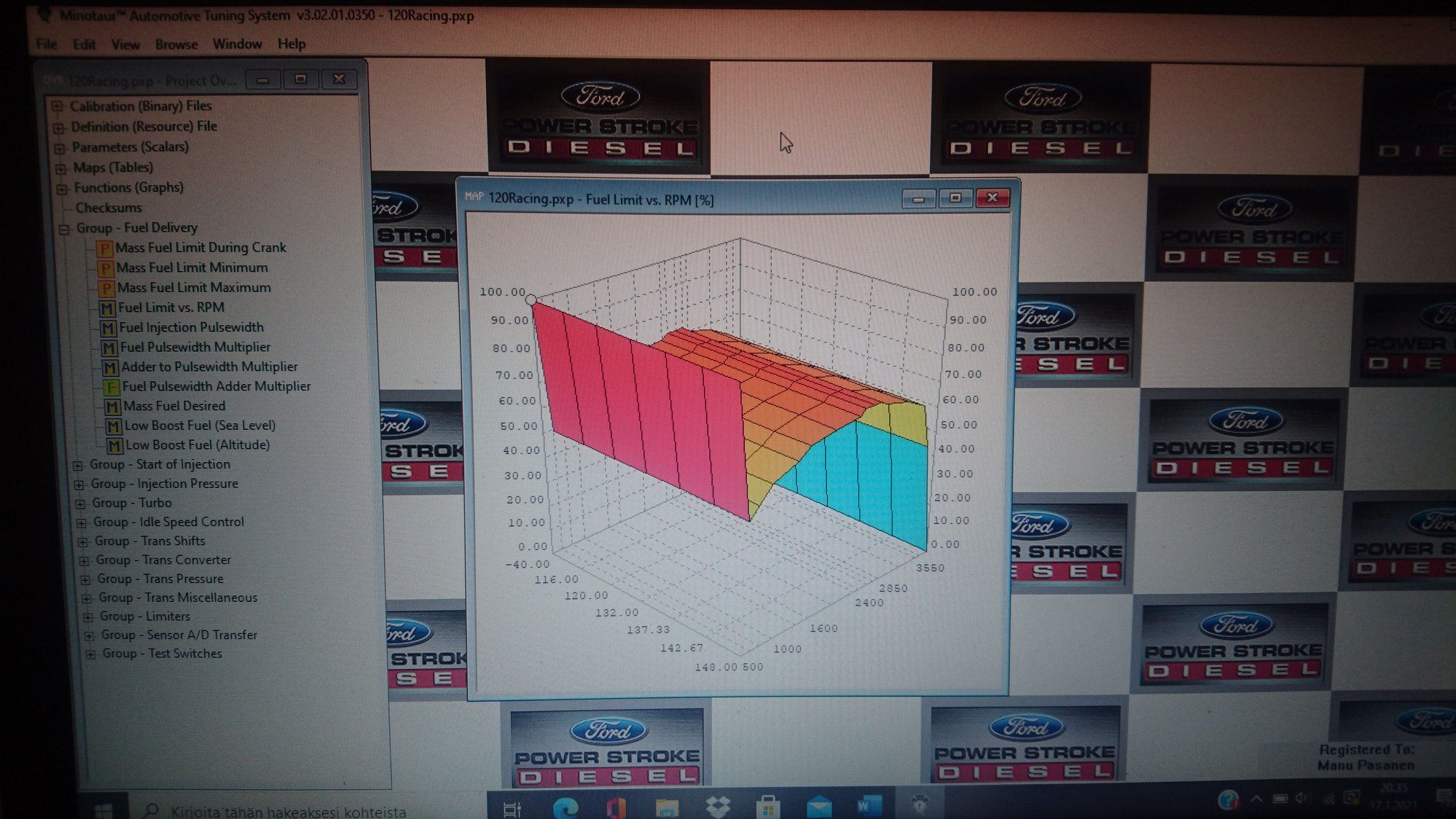

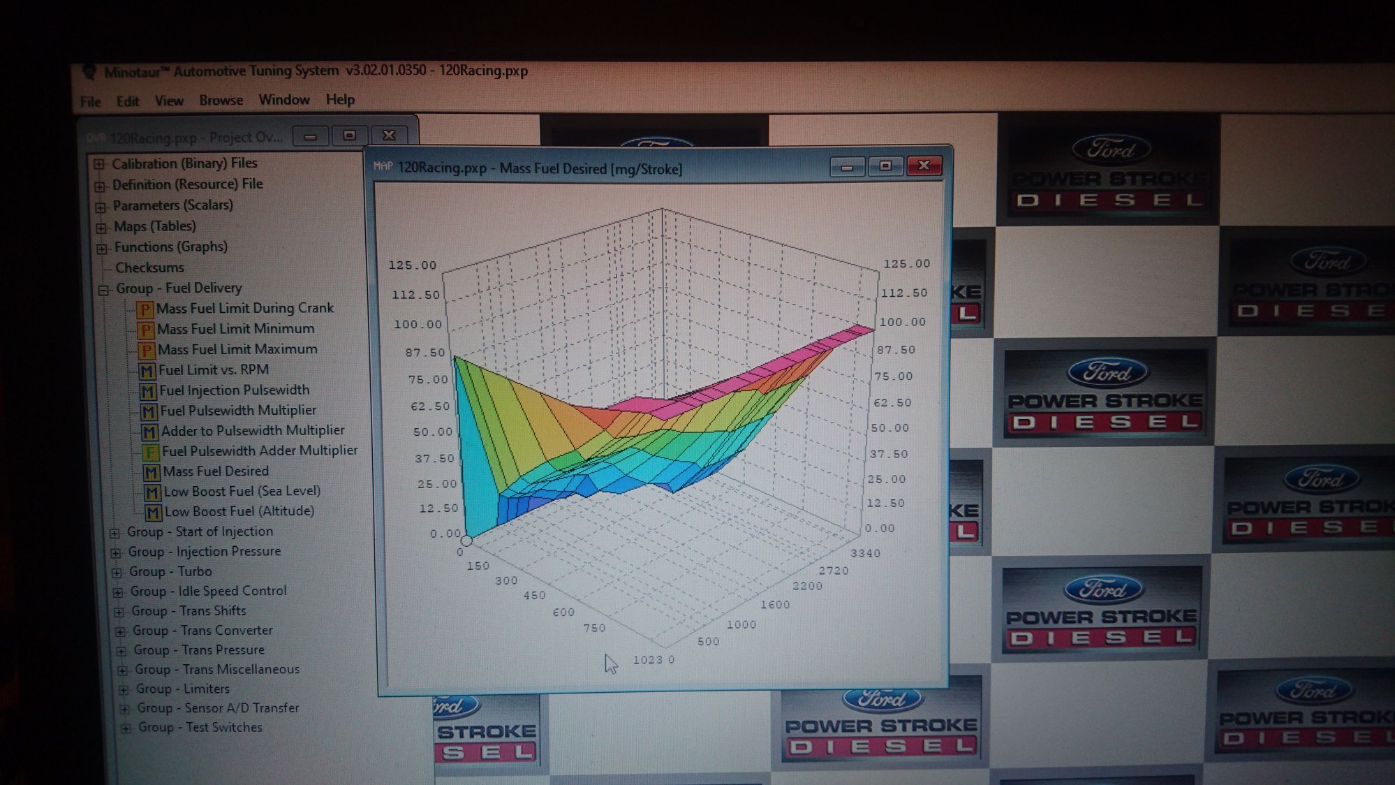

There's atleast 3 tables for fueling in Minotaur:
Low Boost Fuel
Mass Fuel Desired
Fuel Limit vs RPM
Changing any of these will change fueling without any changes made to PW table.But physical PW must change along with fueling changes..
