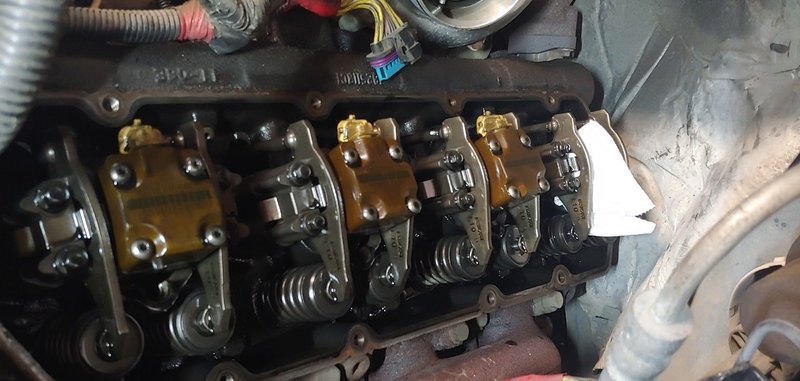

In the middle of my Bitterroot 238/80 install right now.

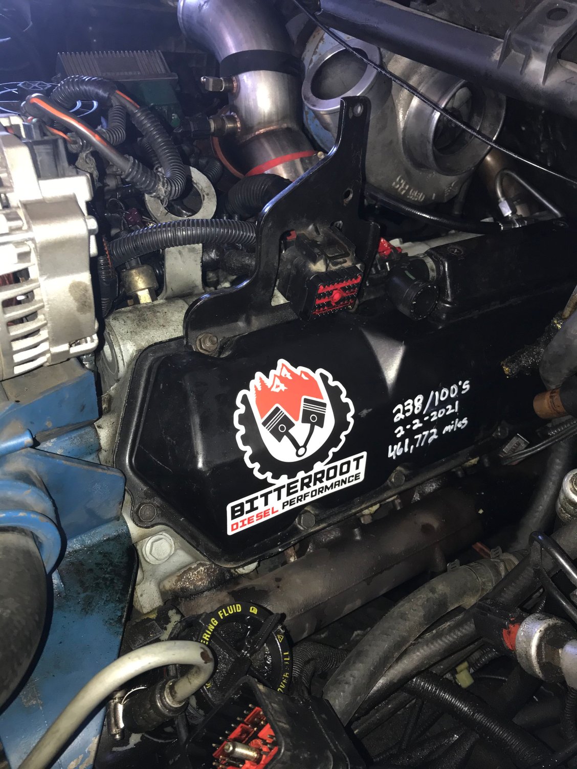

I just put Bitterroot 238/100’s in my truck with GH tunes. Still ‘testing’ but my goal was more power than 160/0’s with no negative consequences.
I am interested to learn if we can pull the fuel back and max out MPG. Currently my lowest HP tune feels quite a bit more powerful than hot tune with the AC codes. So far, it appears I have to manage throttle input below 1800rpm to control smoke (6spd truck). But, I haven’t driven much and haven’t attempted to get tunes adjusted yet. (I WANT to give it 100% throttle at 1200rpm without smoke.., )

many tuners do not use the map sensor. Find a tuner that does use the map to limit low or no boost fueling that would probably go a long way toward your lofty goal,1200RPM zf6 and 100% throttle no smoke is tall order.
I recently started working with SDK and I know Dan uses the map.

So you want 100% throttle under 1800 rpm and no smoke? With tunes and injectors installed and capable of alot more fuel than a stock setup?
Sounds like a pipe dream to me. If, however you wisely used progressive ( but quick) throttle input to increase desired GO POWER , you may find out from the tunes you already have their ( smokey factor) and when they start to smoke in response to throttle position.
To achieve the same results your looking for, you can ( practice ) your throttle input verses your desired response over and over on each tune until you reach max. satisfaction and least amount of smoke. Of course, on any MT the desired response will be more difficult, but can be done just as well.
On the BEST TUNE that gives you a decent response and less smoke, start recording data on those test runs and look at the numbers. Share that data with the tuner and tell him your desired outcome.
Then, I would find the BEST tune you already have that you have been working on regarding above suggestions and go back to the tuner and see if he can change anything in the tune to help. This is the cheapest, and FUN way to play around with what you already have.
I'm in the process of doing that now on my AT and I find there is a certain throttle position that I have to ( pass over) to reduce smoke when I first see it start out the tailpipe. So far, I find that it starts to smoke real bad when I'm demanding (more throttle) when it feels to me like I'm (LUGGING) the engine.
Put another way, it feels like I'm in ( too low rpm's) when I want the truck to GO FAST and my foot is too heavy at the same time.
For what it's worth, I have driven a lot of diesels in my lifetime and find all respond differently regardless of transmission attached. What I do find is we have the ability to wind out the gear/throttle combo for each ratio to get max desired power when you give the engine what it wants.

I agree and I’ve put bigger injectors in a bunch of these trucks. My plan is to do my own tuning soon, but hoping GH can dial it in a little better than what I think I have now (need to drive it more...) To be realistic, I don’t expect no smoke at 100% throttle - but I want to drive normally and not smoke. Specifically, I want to shift gears and accelerate from 1400-1600rpm without smoke unless I’m deep into the throttle.
