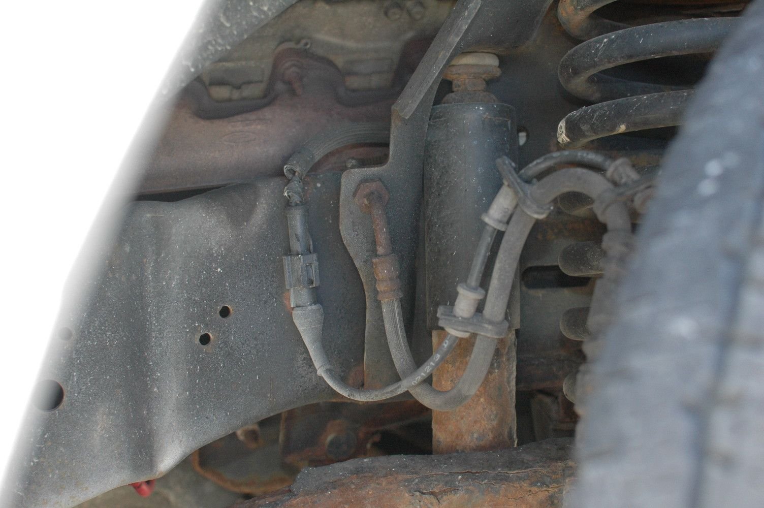

Someone has definitely cobbled those brake lines--what's showing in your video is NOT stock. Up front the hard lines from the ABS unit to their transition to the flexible lines will look something like this:
The other fitting in you hand described as "an obvious aftermarket part" is actually the OEM or original fitting out of the ABS unit where the hard line runs to the fixed point on the chassis where it is connected to the flexible line. Someone has grafted an end fitting for the incorrectly installed flexible line. If you make new hard lines use that fitting for the ABS unit and double flare the opposite end for the chassis side connector.
Yep, thIs van seems to have had a lot of "work done"🙂
The reason i thought that short "L" shaped line was aftermarket because it has the same color as the lines they sell at O'Reilly. That and the fact that it seems like they changed every brake line.
One question. Does the connection going into the ABS unit get an SAE double flare?
