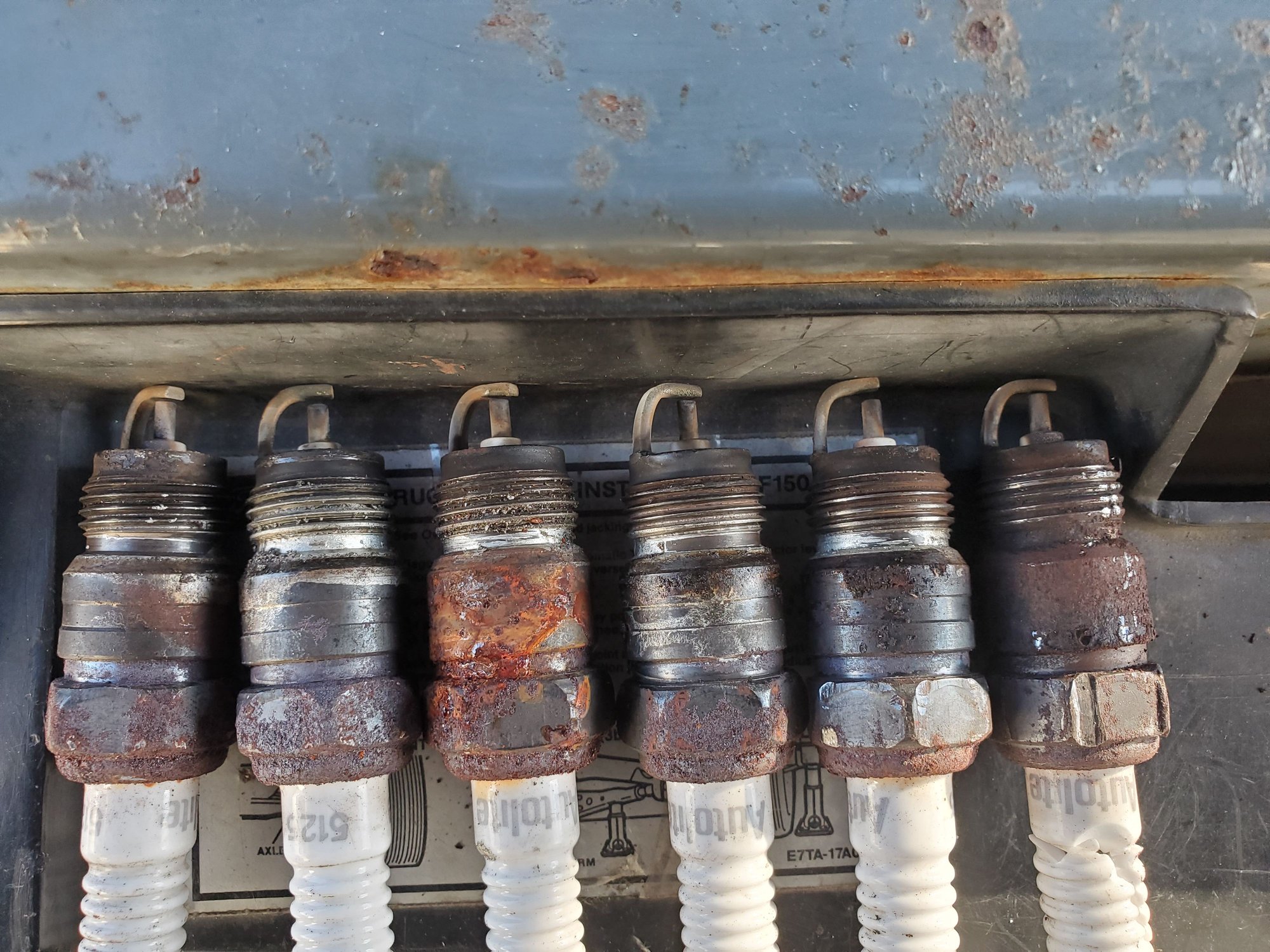

replaced plugs and wires today, removed the knife switch but i ran out of time for the fuel filter. starting is still rough, but improving, 2-3 tries rather than 4+ throttle response is improved and idle is as well, but it still seems to want to "bog down" ... i believe i'm chasing a vaccum issue now
i believe the previous owner and i had two different opinions on spark plug gap

I was wondering if you had dropped most of those plugs..lol

Those plugs are extremely custom
