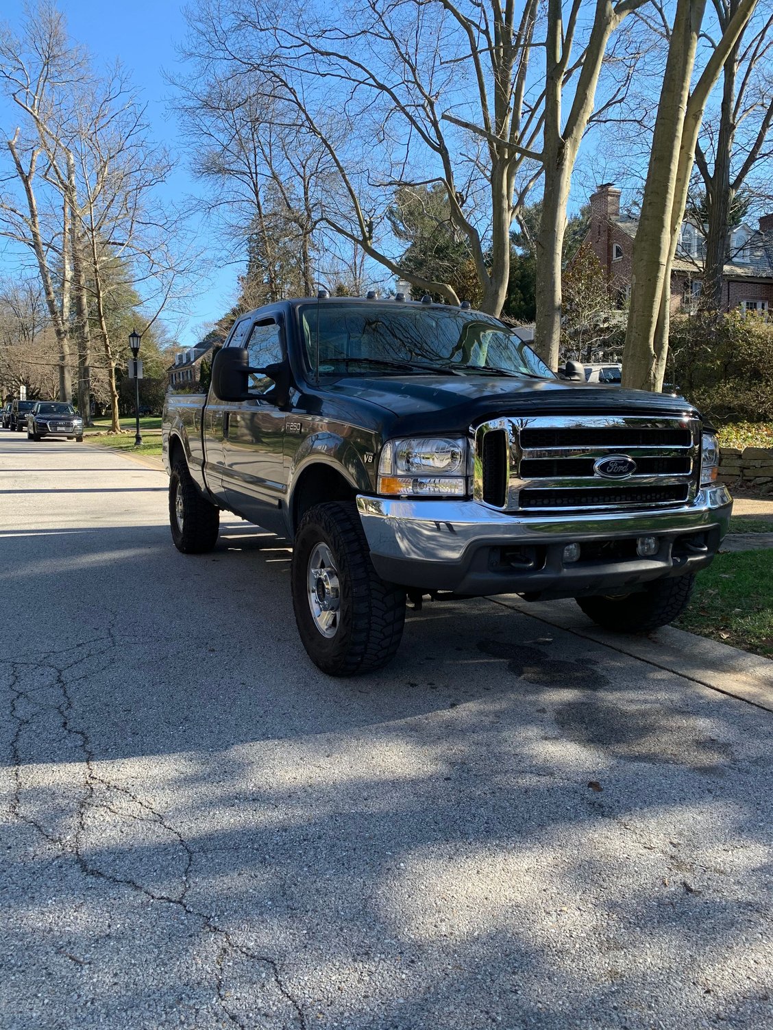

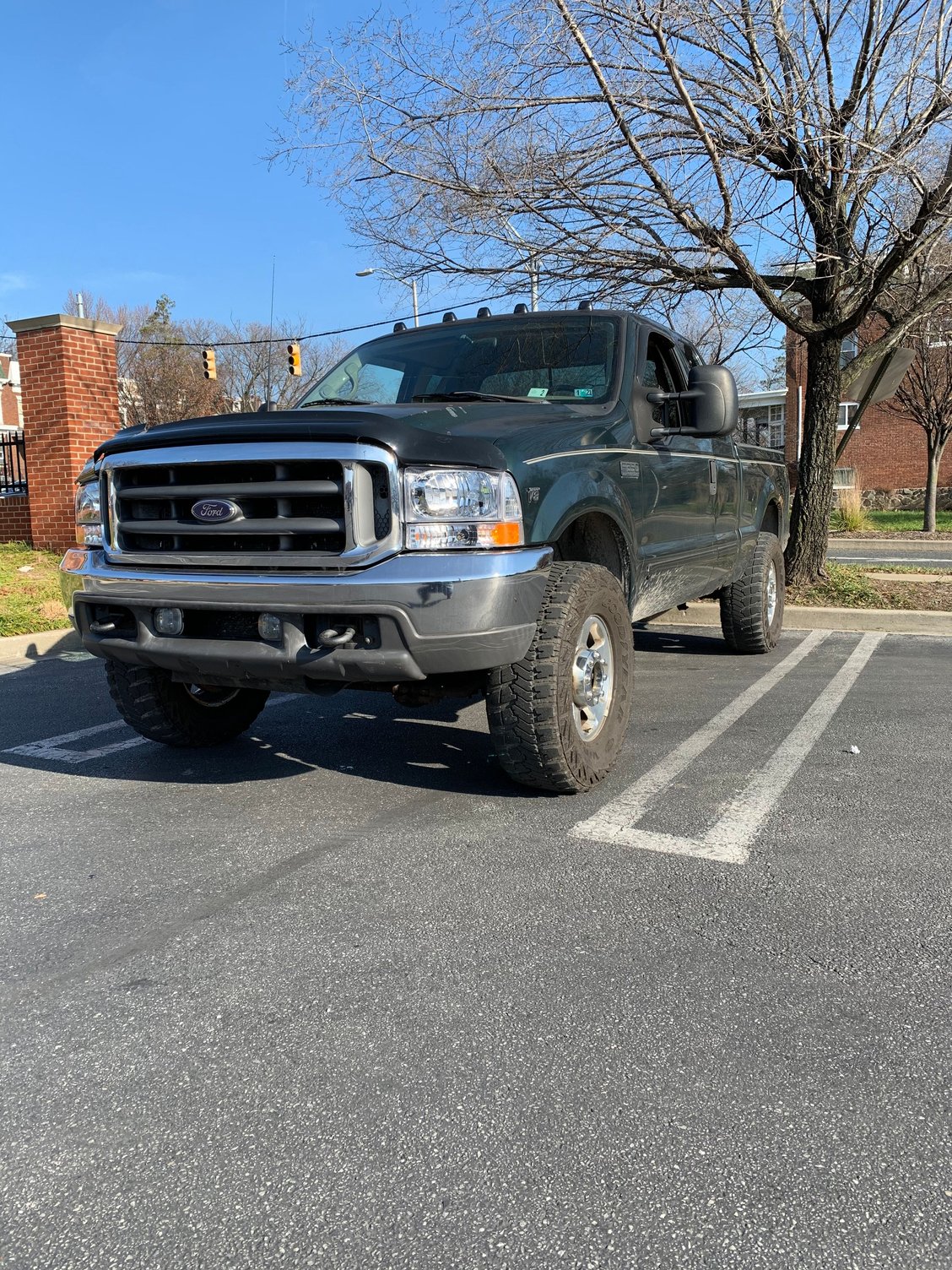

Glad it helped...I made the video after watching other people’s videos where they removed those plastic retainer things and the metal slide clips and on the 250 and 350 and I guess excursion as well you can’t reach behind there easily...so I thought why take everything apart when I can use it on the new lenses...my flashers attach with just two Phillips screws underneath the headlight, although they can be a pain if your driver isn’t magnetic because the top of the bumper gets in the way...since then I’ve done the grill as well
Before
After
I just had one of my LED dogs burn out which is weird because they are supposed to run for like 50,000 hrs. So instead of replacing it I’m going to pay the extra 20 bucks or so and stick in a 22” flood/spot combo light LED Bar where the dogs mounted and just wire it in directly to the pigtails...hopefully it won’t pop a fuse but I’ll deal with that when I get it put on...
