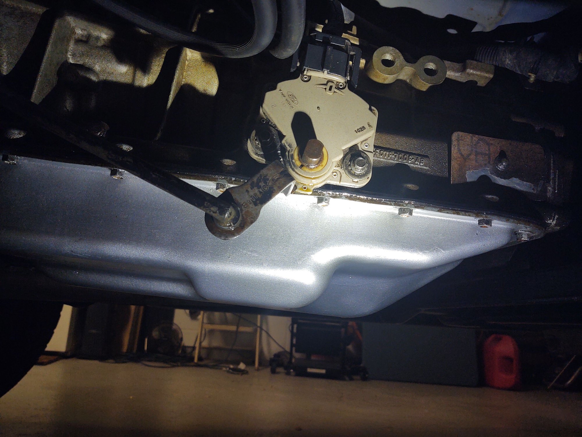

E4OD

Yours seems positioned like mine. If you want to check the MLPS mark alignment, put the truck in neutral and block the wheels . Loosen the two nuts and align the two marks and secure the nuts. Make sure also that your fluid is red and doesn't smell burned. Also check fluid level with engine at operating temperature and while running. Still problems, run diagnostic codes. Sandy
