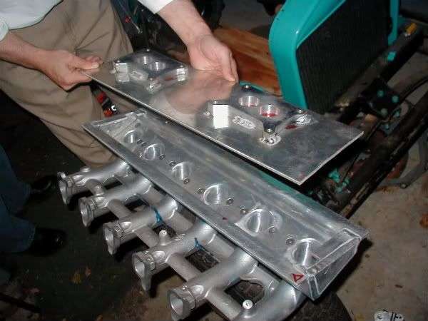

No ****, 166 hp and 278 tq, any idea how well the clifford dual webber setup does?
Eric
Old Jan 2, 2021 | 03:48 PM
pmuller's Avatar
pmuller
Posts: 708
Likes: 111
AFAIK no one has recently used or at least reported on the Clifford dual Webber setup yet.
The alternative is to use the lower half of the EFI intake with a fabricated plenum for two carburetors.
The equal length longer runners should give a better low rpm response as well as better distribution than the Clifford.
You can interchange tops for different configurations.
