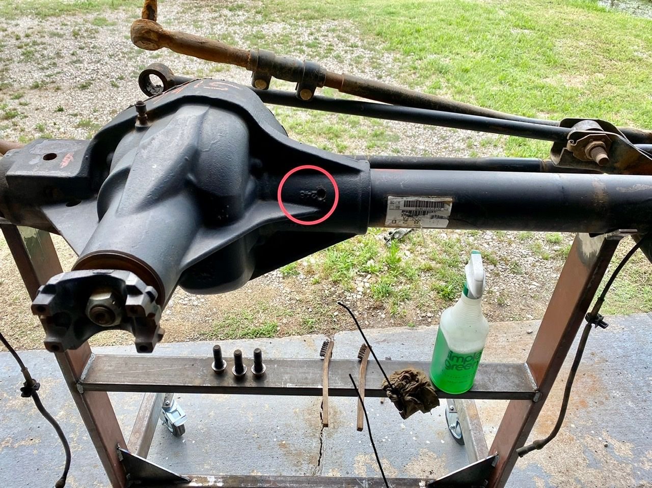

I have a 2000 excursion I am trying to replace right front axle shaft. I have no tag on diff and dealer couldn't help identifying axle.
I want to say its a DANA 60, but my shaft has 30 inner and outer splines.
Everything I look up says its 35 spline. Dealer part # when I google
it shows me 35 spline.....so I am lost here.
Any help would be appreciated,
Thanks

It sounds like you have a Dana 50. Those had 30 splines.

All excursions have dana 50 with 30 spline axles.
try www.venturestruckparts.com if you want genuine spicer replacements or randys ring and pinion if chicom is your thing

As mentioned previously, the OEM was a Dana 50 which is what you most likely have. If a 60 was present, you'd find a "248" embossed in the tube/webbing beside the pumpkin on the upper passenger side.
