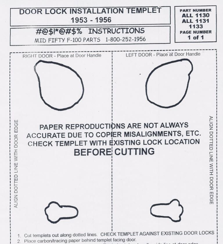

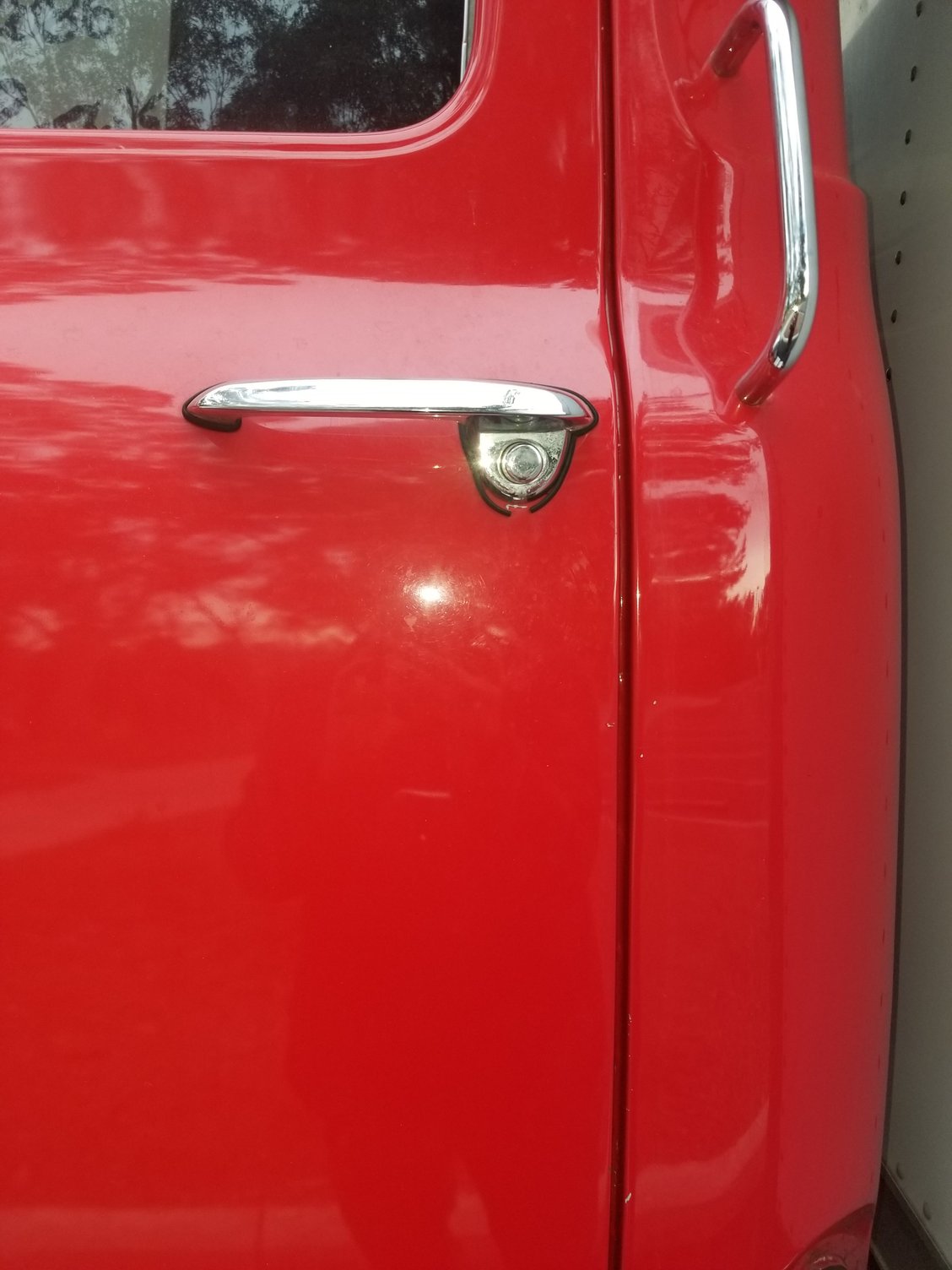

Happy Holiday's Fellow FTE guys! Ethyl *THE* Tool Truck has never had the "optional" door lock mechanism for the driver side door. I have decided to actually fix the door's so they function. The latches finally got so worn out that I was having all kinds of problems. So I bought new latches and wow these doors open and close so nicely. I thought that the passenger door lock didnt lock with the key due to that worn latch on that side also so when it still didnt work after the new latch we found it to also be worn out. I ordered and have received two NOS door lock one for each door of course. I had spent the extra money and used NOS for the latches after hearing your tales of how the quality of the new stuff is. My doors on Ethyl have never been right. The cab has never been locked. I have two needs that I once again am seeking the help of my FTE breatharian. 1. Is there a template for making/drilling/shaping that hole that will have to be made in the driver side door skin? 2. That door does NOT lock right now before we do anything. Any clues to look for thee? I think you are supposed to push the inside handle toward the windshield to activate the lock mechanism and then slide across the seat to the passenger side to exit and then lock that door to secure the cab when everything functions as designed with this passenger door only key lock engineering....to be clear before I add this new key operated lock assembly, .my driver door has never lock period any pointers?
passenger door has the lock mechanism hole..I guess I can make my own template....
driver door no hole yet to add "optional" key lock mechanism

The doors are exact mirrors of each other. The new lock goes into the drivers door in the exact location of the passenger.
Also, the latch mechanisms are the same, door lock or not, and the slot for the door lock clip is behind the weather strip.
Edit: My cab is conventional. The slot for the lock clip was there, in the non-lock door. I can only assume it will be the same for the cab-over doors. Otherwise you will need to cut the slot.
When I replaced my driver's door, I just made a rubbing of the original and transferred that to the replacement. You can do the same thing by making a rubbing of the passenger and just flipping it over.
Mid-Fifty does have a template, but it's not very good: Instructions - Door lock installation template - Mid Fifty F-100 Parts
Cutting into painted doors is always scary. Just take your time, double check everything, and be careful.

Mid Fifty has instructions and a template you can download/print off.
https://midfifty.com/instructions.php?ID=481
