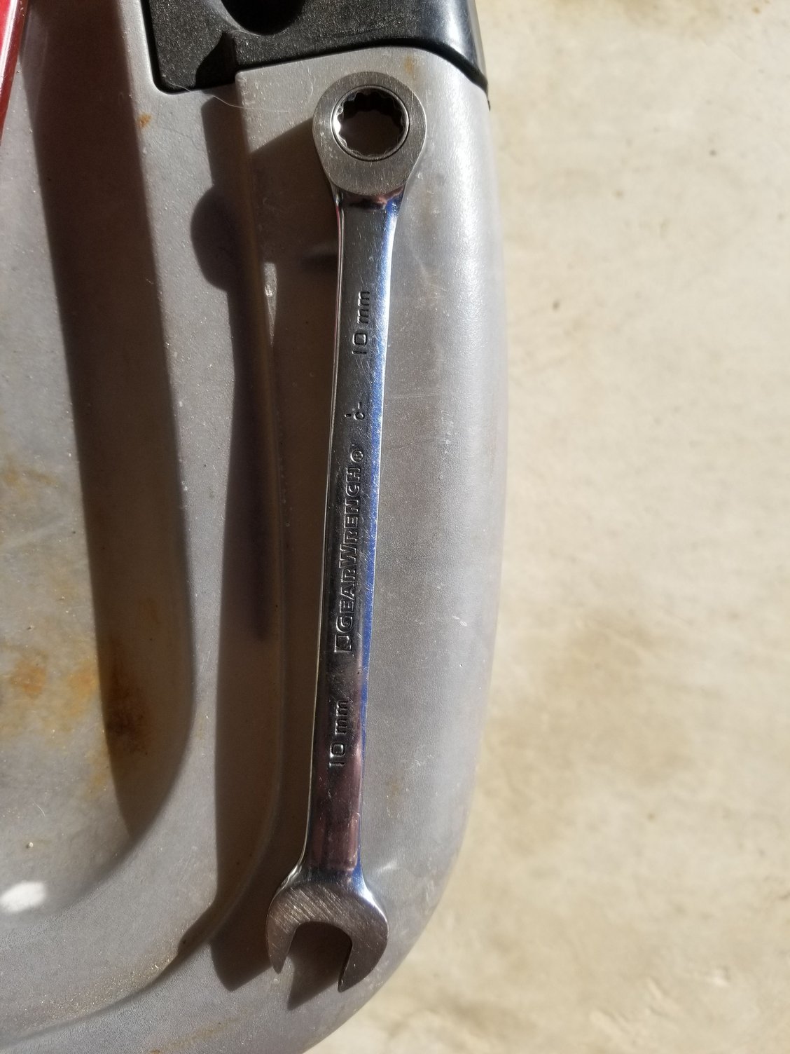

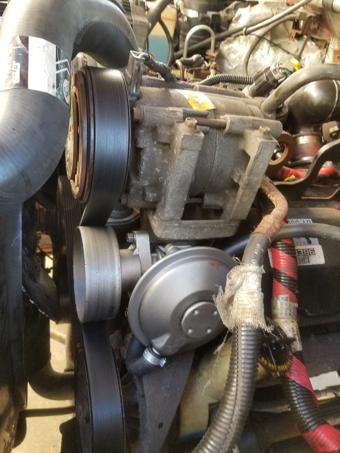

Vacuum pump done, tips and info!
after replacing the tensioner assembly it sounded like the vacuum pump was squealing more than it should. I managed to replace it without gear puller. O'reilly's carries the complete pump with pulley and bolts in place. I managed to extract the old one with one of my favorite wrenches. the GearWrench ratcheting 10mm was the perfect tool for those 3 bolts. Not easy, but at least possible, I bet I've had that set of wrenches almost 20 years. She sounds pretty good now.

Best mod I did to my OBS vac pump was installing studs, no more removing pulley as well.
