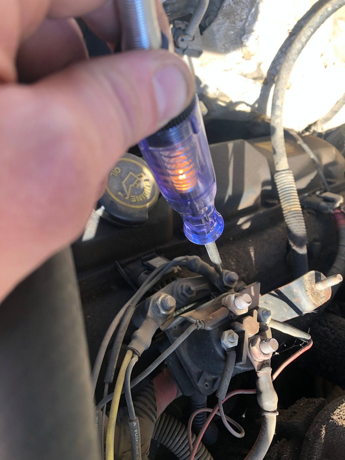

Had this problem on a friends 7.3. I was helping him figure it out. First thing I did was new change on the batteries hooked them up and left the truck off. Put a test light to the glow plug side of the relay and sure enough it was stuck on with the key off. New one fixed the problem

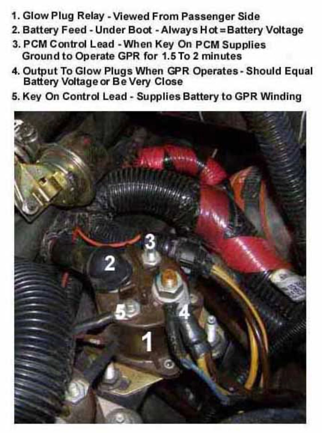

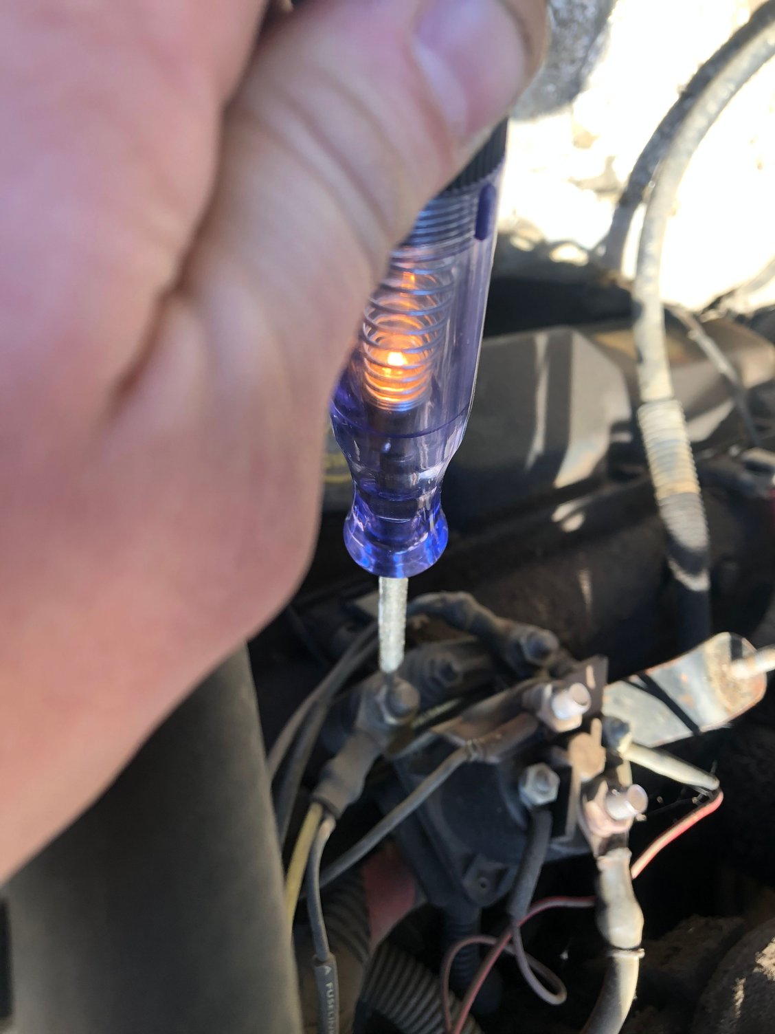

so test terminal with brown and yellow wires? #4
Old Dec 6, 2020 | 03:16 PM
96 OBS's Avatar
96 OBS
Joined: Oct 2019
Posts: 949
Likes: 109
From: Fowler Colorado
Yes just to see if it has power when key is off then it’s stuck on
Old Dec 6, 2020 | 04:35 PM
Erik350's Avatar
Erik350
Joined: Aug 2020
Posts: 7
well I think the glow plugs have been staying on. Key is inside on my desk.
