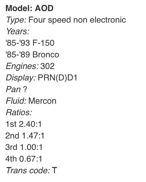

The trans code on the decal on the drivers door pillar will tell you what trans it had, T is AOD, U is AODE/4R70w, E is E4OD, G is the C6 I think.

Do you have an overdrive position in the dash or is it just “D” with no circle? Just wondering if it had a C6 and the PO didn’t bother to replace the indicator in the cluster.

So I double checked and the truck does have a D with a white circle behind it, then a regular D, and then 1, so I take it that means this truck was overdrive then? Which if this truck does have the original trans in it that makes no sense as to why my trans mount does not fit the trans.
edit; alright so I’ve decided I am slightly blind haha- after coming to a conclusion that it is the original trans, I decided to throw the mount back in to get another look. Turns out that I just had a weird angle on it, so rather than the mount being too narrow for the trans, it appears that the rear of the trans is off just a little bit and just needs to be pushed over for the bolts to go in. Gonna finish up my fluid change and give it a shot putting it back on.

That matches what you should have.
If it is all distorted you might want to consider replacing the mount. You could probably get one shipped to your door from RockAuto for < $10.
