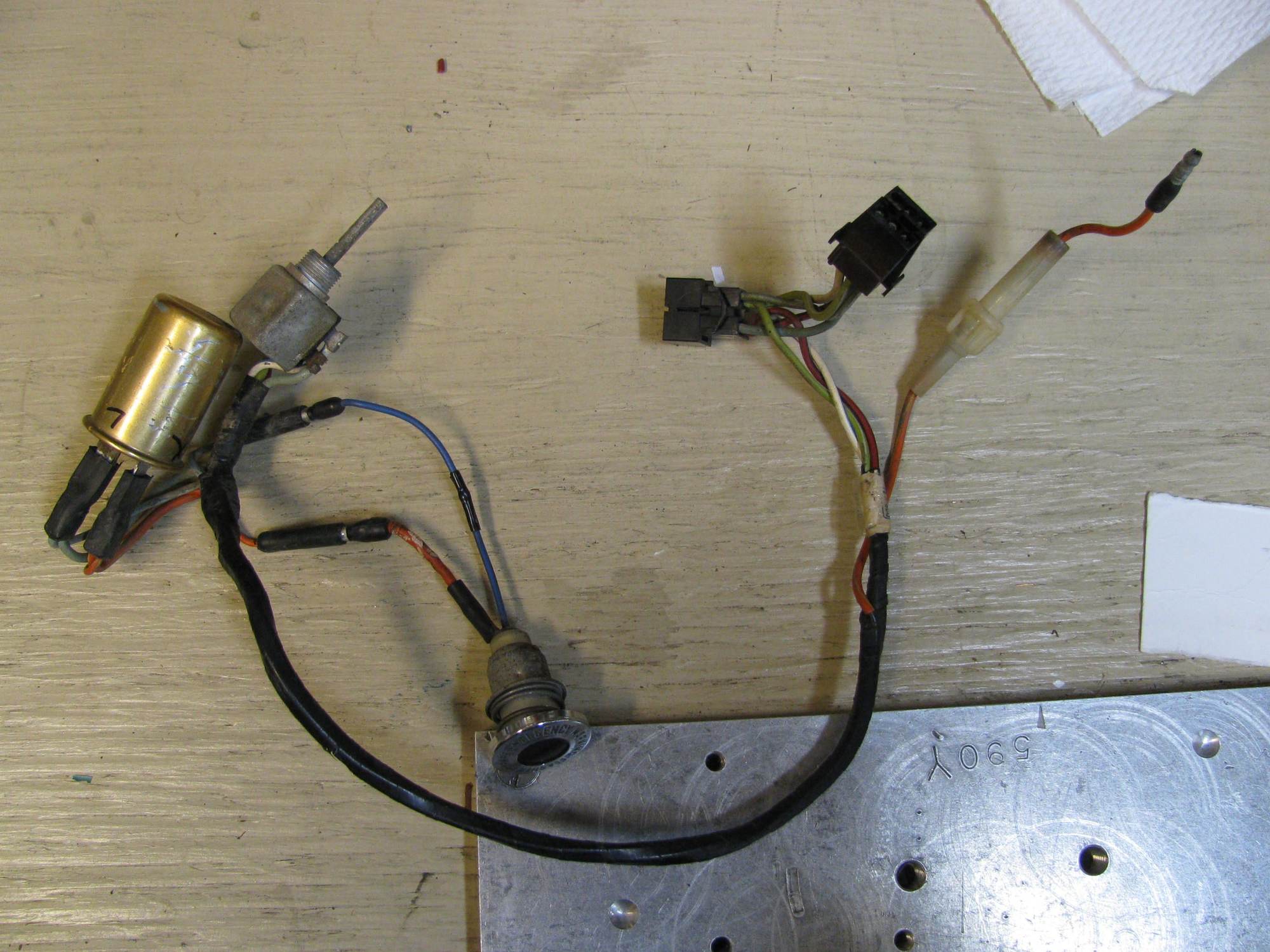

Look at the switches, too. The built-in style has a switch that can be unplugged from the harness - just the switch alone shown in post #9. All others the switch is soldered to the wiring.

Don_1966 here's a picture of the bezel that screws onto the switch to hold it in place in the dash.
Dennis Carpenter and I believe others have their numbers wrong. For the indicator bezel they use the part number for the switch bezel.

Originally Posted by dubya TF
Not to thread jack but.....there's no differences in the underdash harness for emergency flashers correct? I've wanted to add them to my truck just because.
This is the flasher harness that was an add on. It just plugs into the TS harness at the steering column. These turn up on e-bay every now and then. The thing about these is the dash bezel. It isn't reproduced and it is different in that it doubles as the nut to hold the switch in.
Thanks for the info Chad. I don't have my laptop and my MPC here at work and the mind wanders with ideas some days. lol My truck is 624xxx serial so I'd have to find the add on deal like Crop Duster shared. I take it these are limited to '66 or '67 and prior?

Thanks for all of the information. Now I just need to find all of the components. At least I can complete the interior assembly and add the flasher when I get all the parts.
