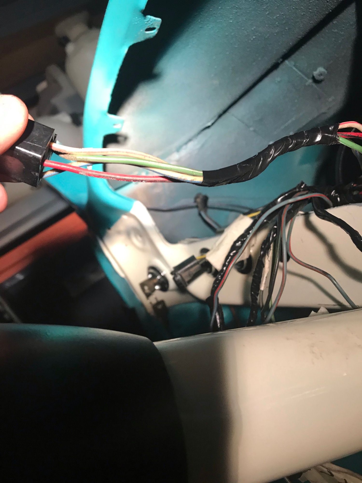

I am working on finishing up the under dash wiring but I cannot identify what this plug goes to. I’m working on a 1966cc with the original wiring harness but I did not get a picture of this plug when I removed it.
Every accessory or gauge has been hooked up. It had an aftermarket emergency light switch but it was spliced into the turn indicator wiring from the steering column. I removed the switch but I don’t think it relates to this plug. What did I miss?
The colors of the wires are red with black stripe, green with white stripe, white with blue stripe, and white with red stripe.
Any ideas?

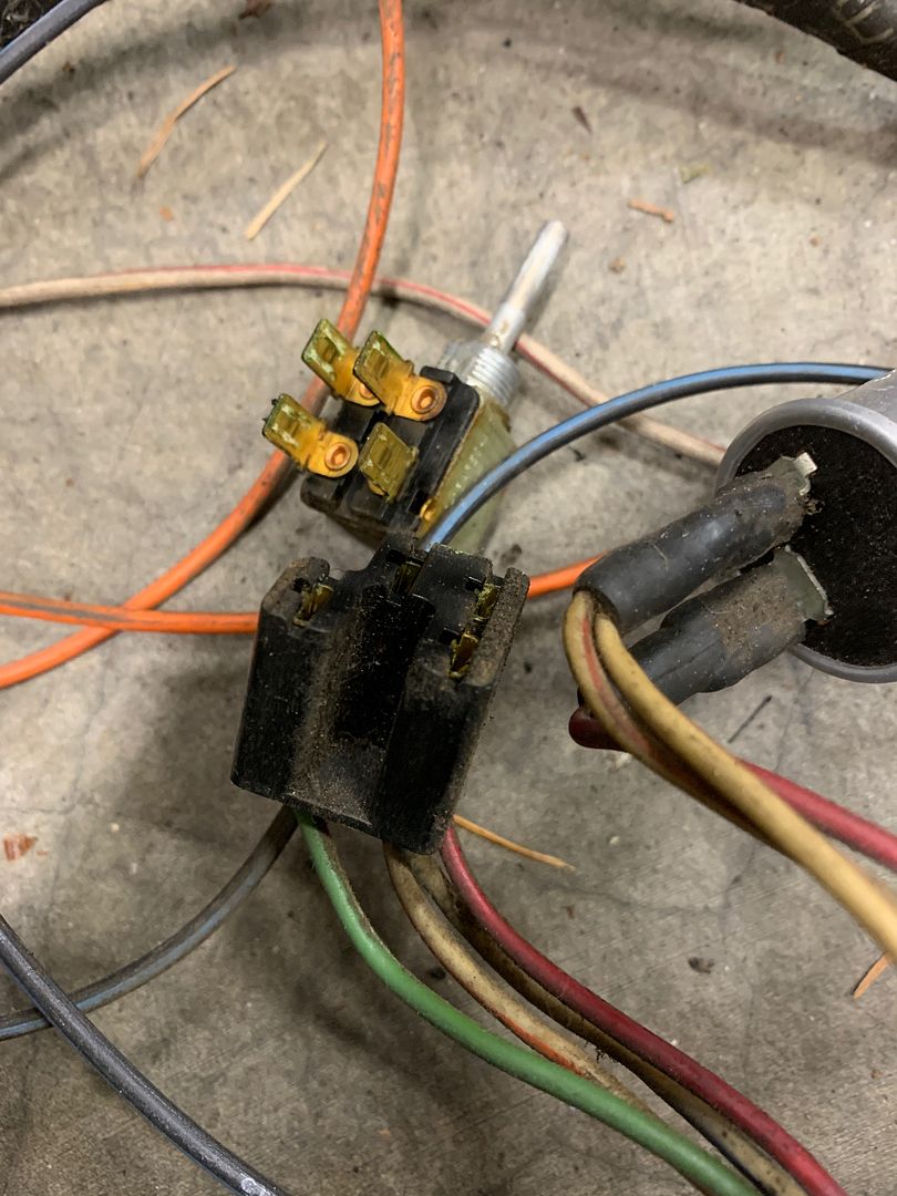

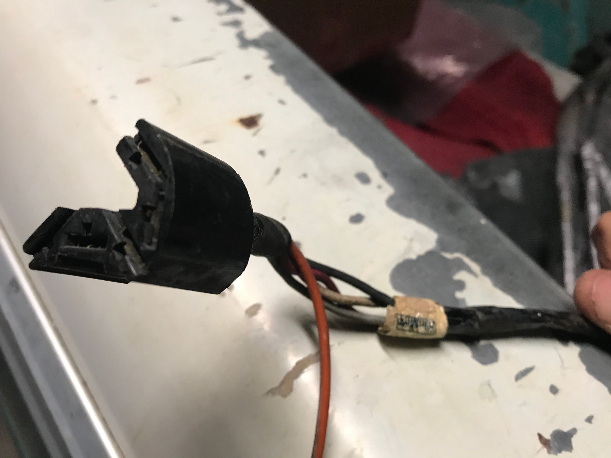

Not the wiper motor.
this is the wiper motor plug and it fits the switch.

Don....sorry. It looks like the Wiper plug on my 66. The second one you show, I don't recognize. Maybe differences there...I'm sure someone will clarify.

The plug in question comes out of the wiring harness not off the wiper motor.
The part number off the tag of the harness is
C6TB-14401–DM
Best I can tell the harness is original and hasn’t been cut into or molested until I did to verify the integrity of it.

That is for the built-in e-flasher. Same as my truck harness. The switches are not hard to find. Let me grab the part number for that.

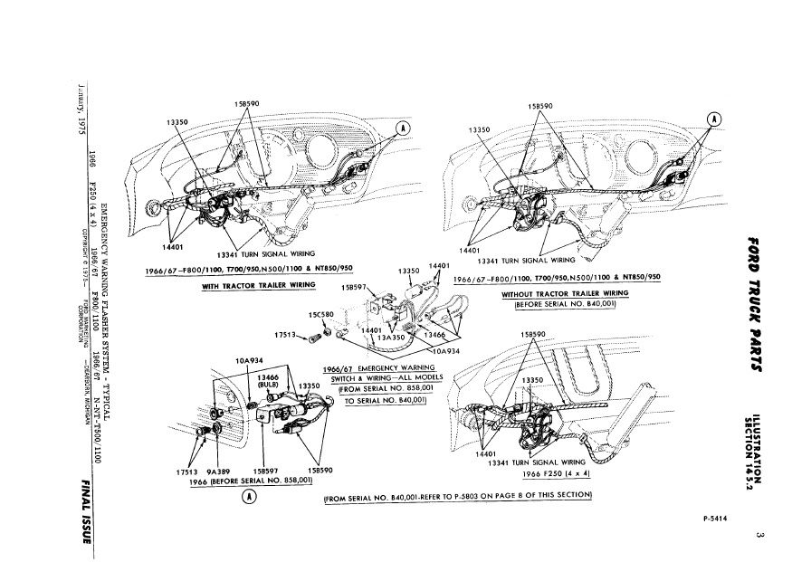

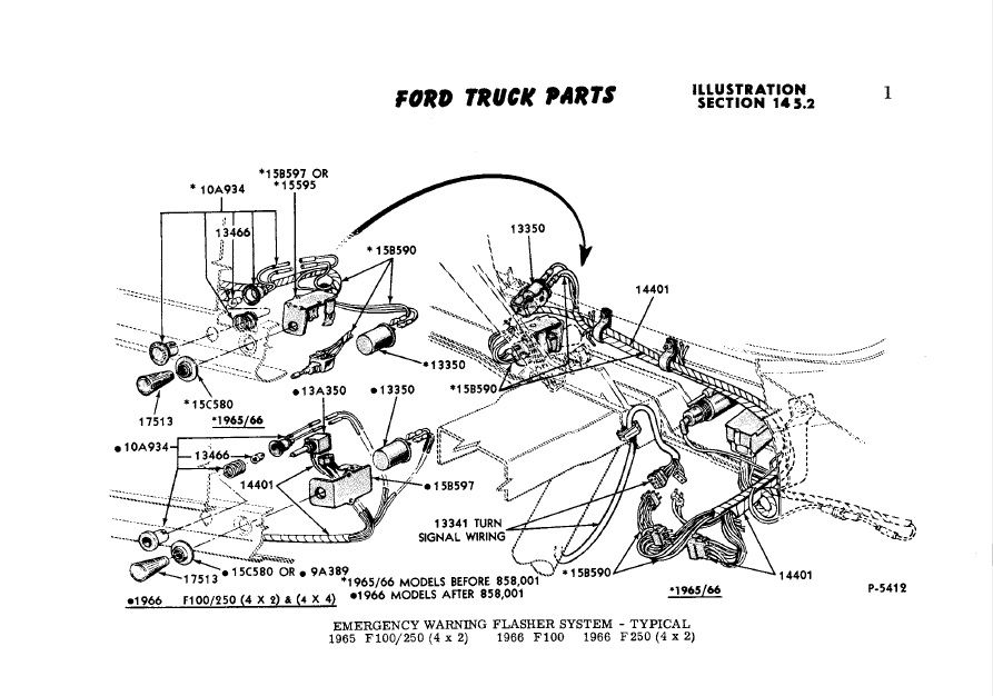

The C6TB-14401–DM harness is different than some. With this harness the emergency flasher wiring is "built-in" right up to that plug and the flasher wiring and everything. Other harnesses have a provision to plug in the switch, indicator and flasher as an assembly.
My 1966 F250 2WD truck has them "built-in" since it is after 858,001 - where my 1966 F250 4x4 trucks both before 858,001 - while they both came with emergency flashers from factory - they are the plug-in type of flashers.
At this eBay link is the add-on type of flashers. This has the bracket to support the switch and flasher. This one ad shows the indicator also, which has two single wire plugs that link it in.
https://www.ebay.com/itm/1963-1964-1...5/312568778781
There is also the separate switch and wiring alone
These two pages from the MPC show some of the details. Lots of information on both - that 858,001 cutoff is where they changed to the built-in style.
