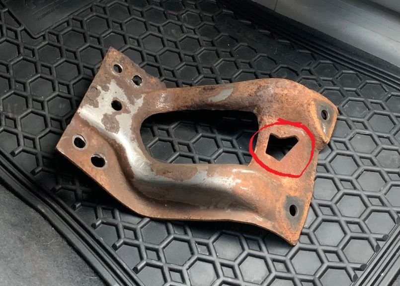

Here is a picture of what the forward left bracket looks like for the midship tank strap. I circled in red the hole where the "T" end of the strap hooks into. This is a used bracket I got at the local junkyard to replace mine that was rusted out.

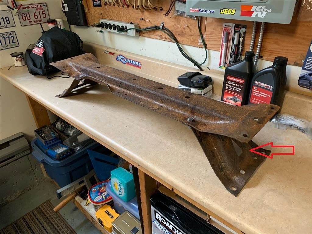

The rear crossmember has different holes for the strap ends that are triangle shaped, see below. Again, they are known to rust out and fall apart, especially on the driver's side where the straps attach. (The red arrow is pointing at the passenger side bracket, but they are the same left and right regardless).
Perfect, thats it exactly.
It's the rear one and it's that bottom angled piece.
I assumed it was NLA and also figured it's going to be fun locating a good one.
Thank you for the pictures!
