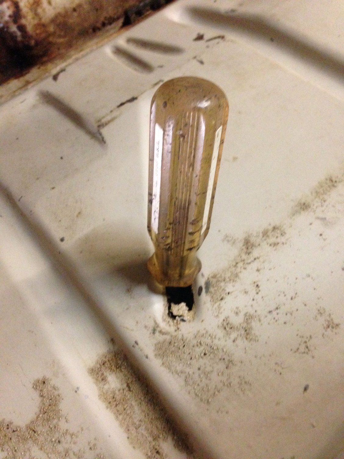

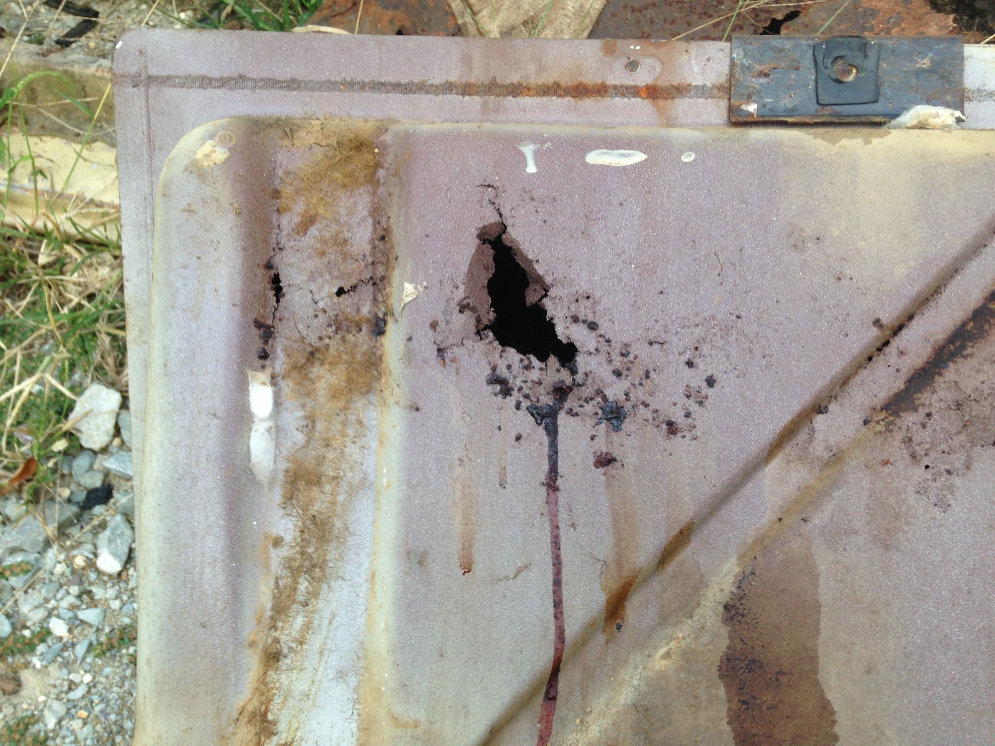

This is a very timely thread for me because yesterday I pulled to tank out of my '65 that I purchased a month ago. I am doing a complete brake system replacement and had some down time waiting for some parts. So I decided to pull the tank out (it smelled inside the cab to high heaven). Well I was shocked to find the tank had rusted thought in several places. See pic
Now I think I will look at putting a tank between the frame in the rear. I need to keep this as simple as possible. I will look for other threads however if someone already knows of a good thread with pics please post it.

Holy Smokes, I'm going to guess that you're not a smoker. I think if you were you would have gone up in flames. Good thing you found that before something bad happened... ~Pat
