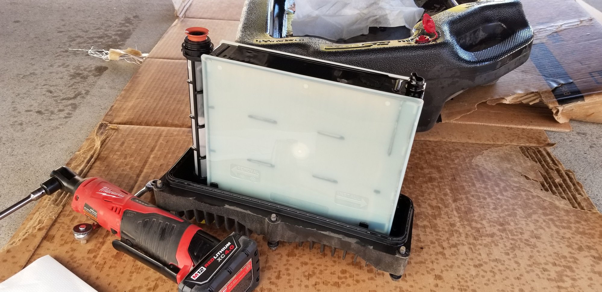

20K seems like way too much. On my 19' I'm going by the Ford Pass OLM(20%), and I've changed mine at about 8K. It's pretty nasty by then.
Did first fuel filter change at 15K. Panel fikter looked really clean.
So much better(less messy) than my 6.0l.

Yea that filter look great.
That might be the new one. I don't remember. The old.one did look just as good, I swear. LOL
I just wanted to show.my 6.0l buddies what it's like to change them without getting a diesel bath.
