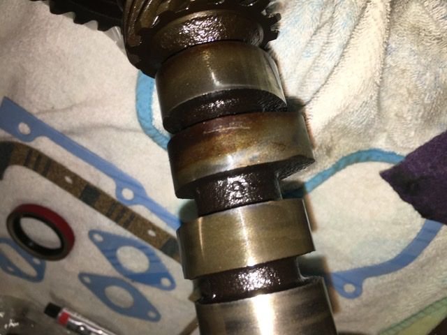

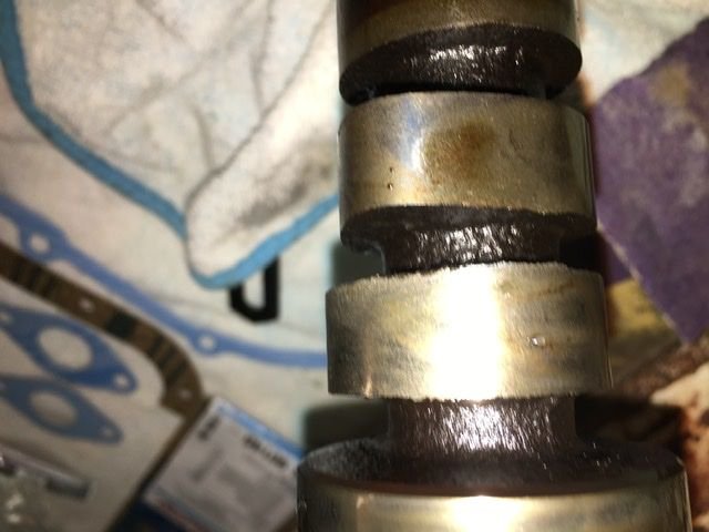

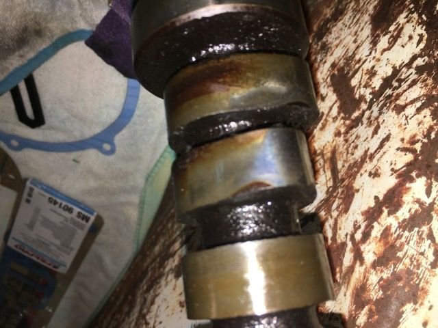

I just pulled my cam out, the bearing look excellent, and I removed the heads and you can see a little cross hatch, I’m beginning to think that the previous owner saying it was never rebuilt was not true. Or at least not to his knowledge.
I have attached the pictures of my cam, it looks okay to me but I’m a beginner. The pictures are the few concerning spots I have, there’s the small areas that look like chips but also look like it was cast and ground that way. I don’t know, and then there’s the dark spots.
Two lifters were collapsed. The new ones I have are slightly taller on the outside, but when you look at where the pushrod sits, it looks to be correct. How can I measure this to be certain?

Cam wear looks normal. But unless you stored the lifters in the order they came out, you'll need 16 new ones. With any new lifter, visually inspect the bottoms to verify they're machined correctly and have a convex face (slightly domed). Try using heat on the spacer and lightly tap on it with a ball peen hammer to loosen it. Might also try taking those two collapsed lifters apart and see if they can be freed up to reuse.

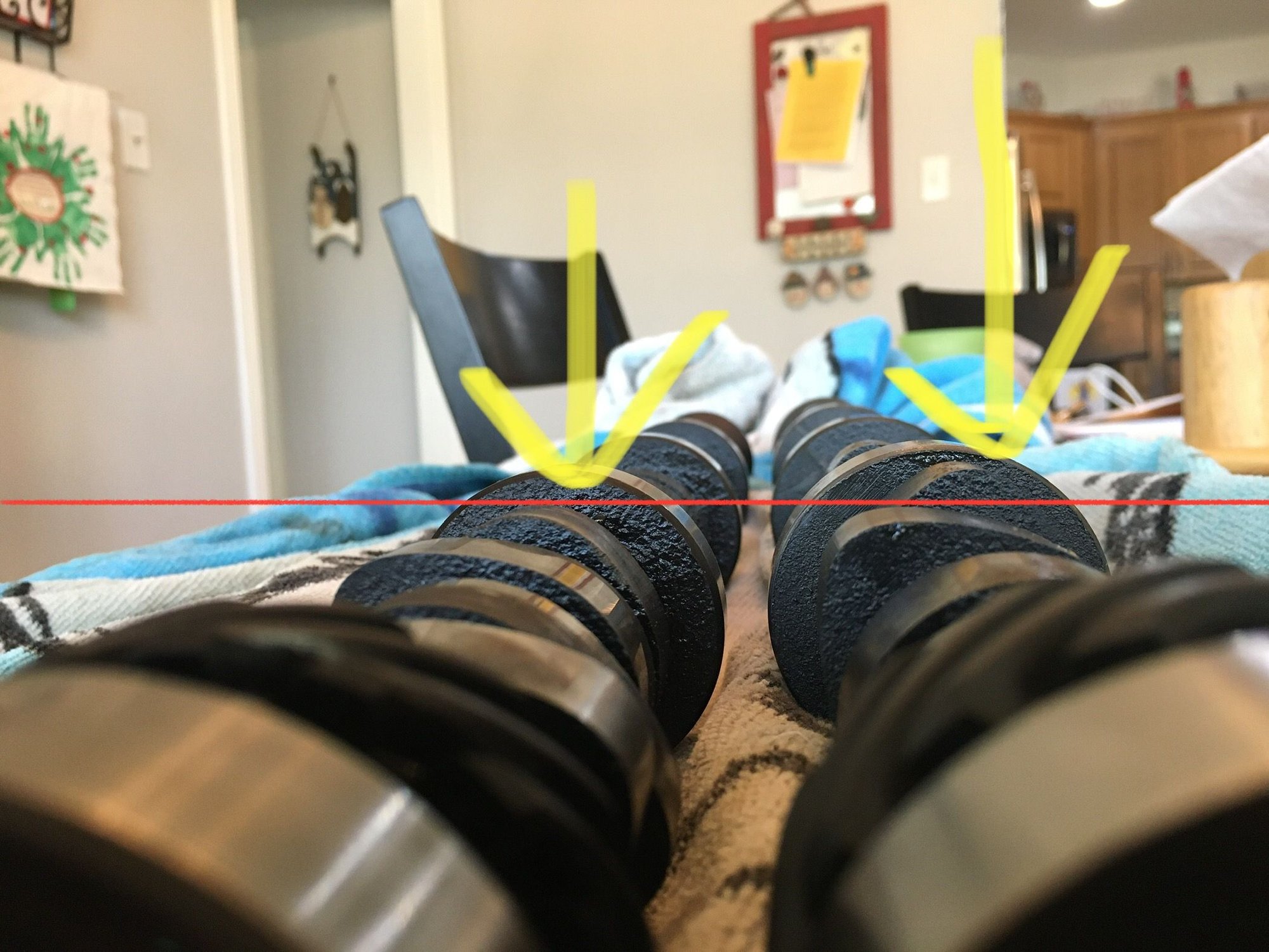

I already have new lifters and cam, found a stock one. I also found the source of an issue, on the left is the old cam and on the right is the new one. Only two lobes were worn this much, I think this old cam is a goner.
I think you are right. That there is a flat lobe.

I wonder if it’s just been worn down over time because all the bearings look exceptional for the age and all. There were no metal flakes or glitter anywhere.
This lobe also happened to be the area the ticking was coming from. It makes sense because the extra room.
