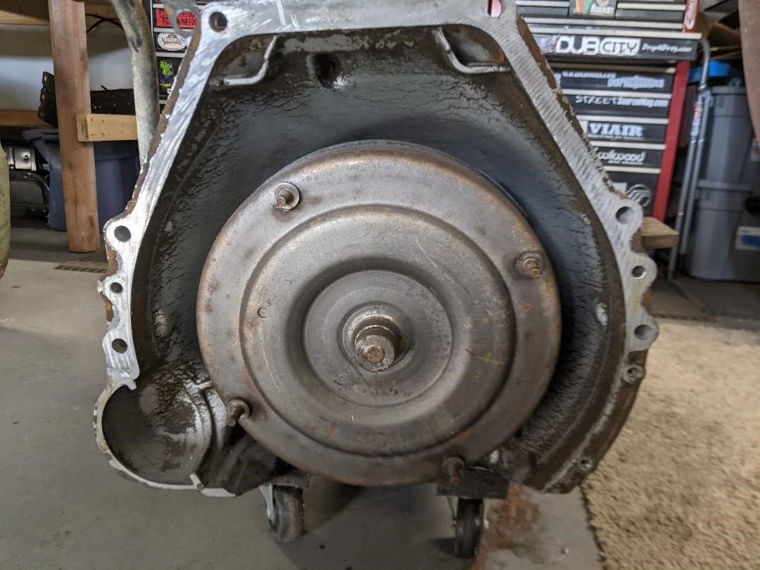

I'm new to the group but have been using it as a resource for years. So as my first posting to Ford-Truck.com, I have a question about the E4OD casings.
I know there are generally 4 types of E4OD transmission casings. 4x2 (SBF, BBF) and 4x4 (SBF, BBF). I locally picked up a used cheap transmission, and planned to use it for mock-up purposes and as a core for a new one. But when bolting it up to my BBF, I noticed this transmission doesn't have holes for bolting up a starter.
Is this still an E4OD? What did this transmission come out of? is there an adaptor Im missing?
I appreciate all the help!
Sorry, that's wrong.
There are three E4OD cases. SBF, BBF, and diesel. There is NO difference in the case between a 4x2 and a 4x4. The extension housings are different, but the cases are not.
Did it bolt the BBF? Were there holes in the engine that didn't have corresponding holes in the transmission? If so, this is a diesel case. And yes, that is an E4OD.
But not a 99-03 diesel, correct? It would be a diesel from years prior. I want to move his thread to a forum of owners with similar vehicles, but am still not sure what he has, or what he is working with.
It doesn't have an input speed sensor and it has a provision for the output speed sensor on the tailshaft housing so it is not for a 99-up application. Your gut feeling is correct.
E4OD for either an early DI van or even an IDI pickup.
The E4OD was not in any 99 or newer truck. It was replaced by the 4R100 by then. And the trans pictured is not a 4R100.
