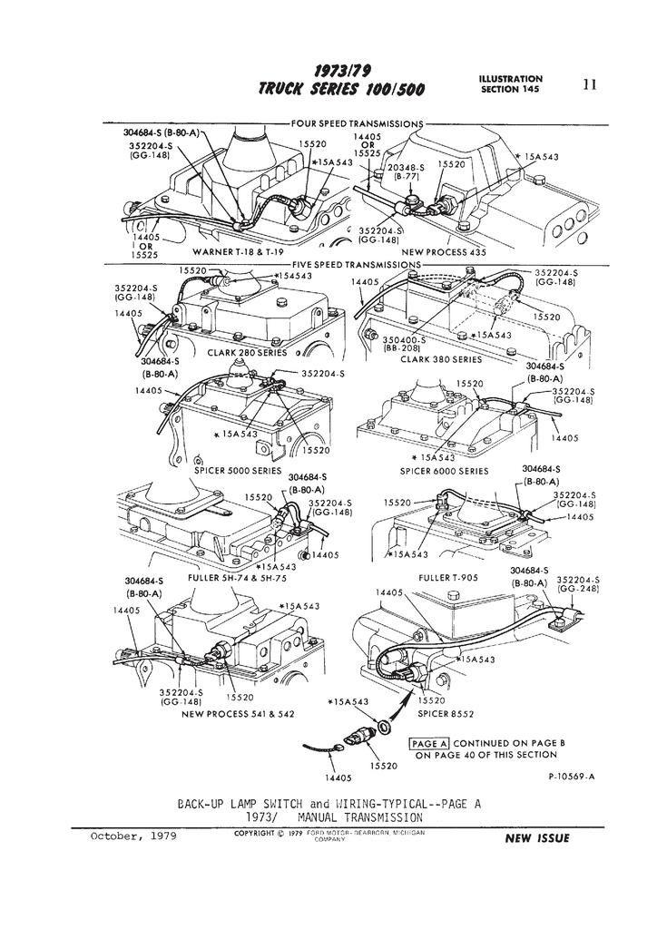

Here they are.

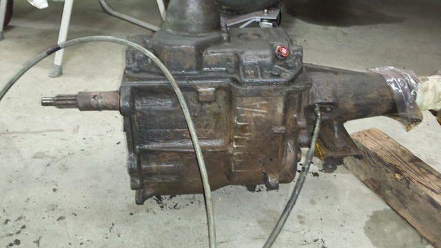

I just bought one for my truck at Rockauto. Here is what it looks like. Might be the same as yours?
Tom

The T18 & NP435both granny transmissions have the BU switch in the top cover.
T18 red switch in the top cover to the rear
NP435 again to the rear of the top cover. That is the Advance Adaptor overdrive in front of the NP435.
On my 81 F100 the harness run along the transmission cross member to the frame rail.
If you short the 2 wires together the lights should come on.
