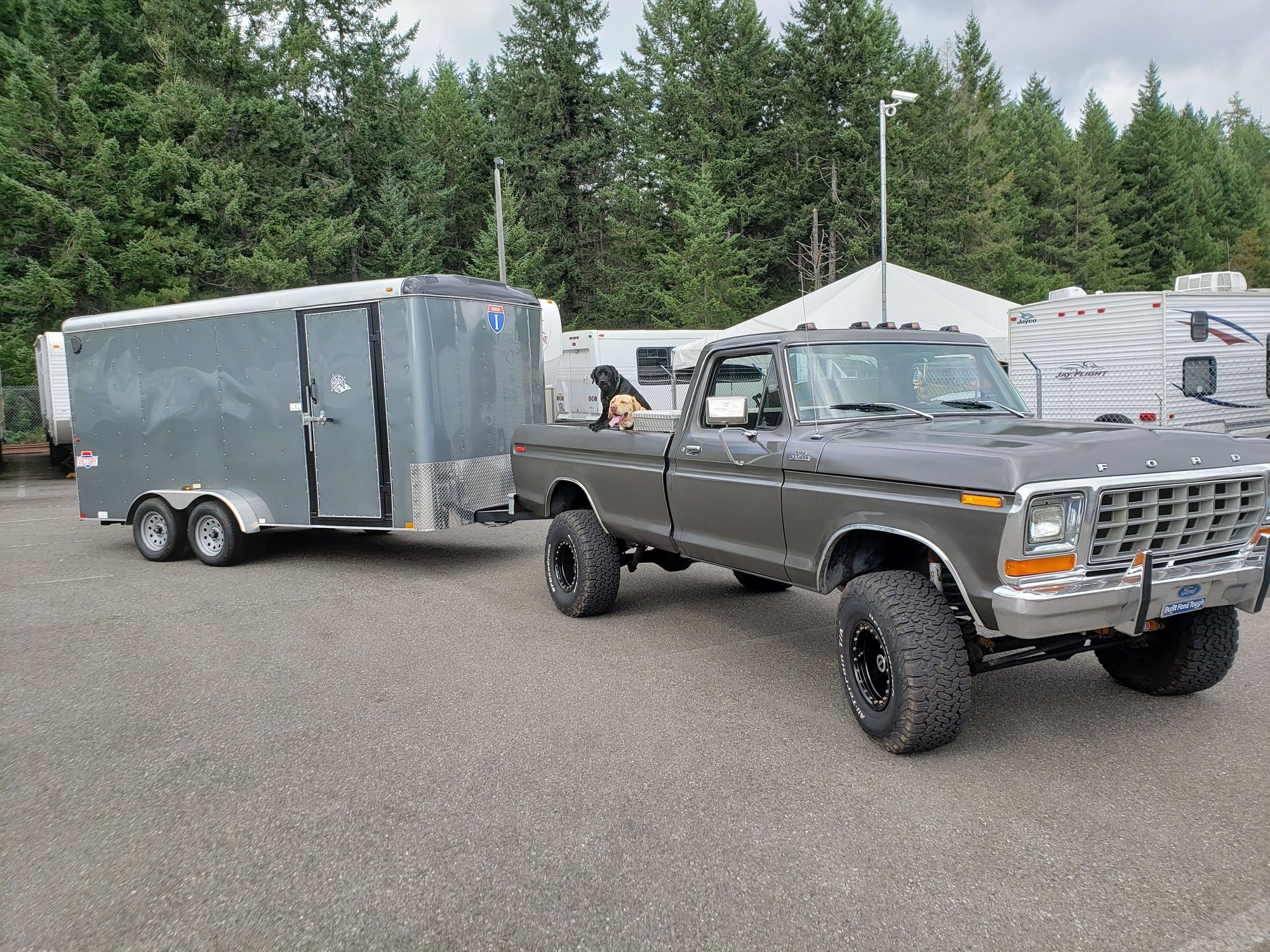

I have this exact set up, except with a 351M. Every once in a while I pull a 16' cargo trailer with my toys weighing in at about 5,000 lbs combined. My truck pulled pretty good up to 55 mph. Anything past that she struggles. I imagine your 460 will do a little better pulling. But with 4.10 gears, it would be a lot better.
