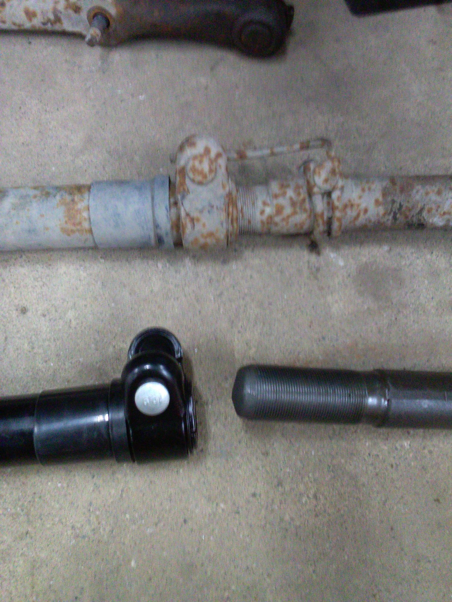

I bought all new Moog tie rods and a drag link and they don't include the adjustment holders. Are they even necessary?

When you tighten that clamp down after adjustment, I don’t see how it could move. The new design is just that, a new design to do the same thing. Engineers being engineers. I can say that because I am one.

The Moog adjustment holders are sold separately and are not included with the tie rods or center link. I rebuilt a 2006 front end in September and made sure I ordered the holders with all the other items.

... But my inners included the beasts??? This was a few weeks ago, but maybe yours were resold, defective, mispackaged, manufactured on Friday.....
