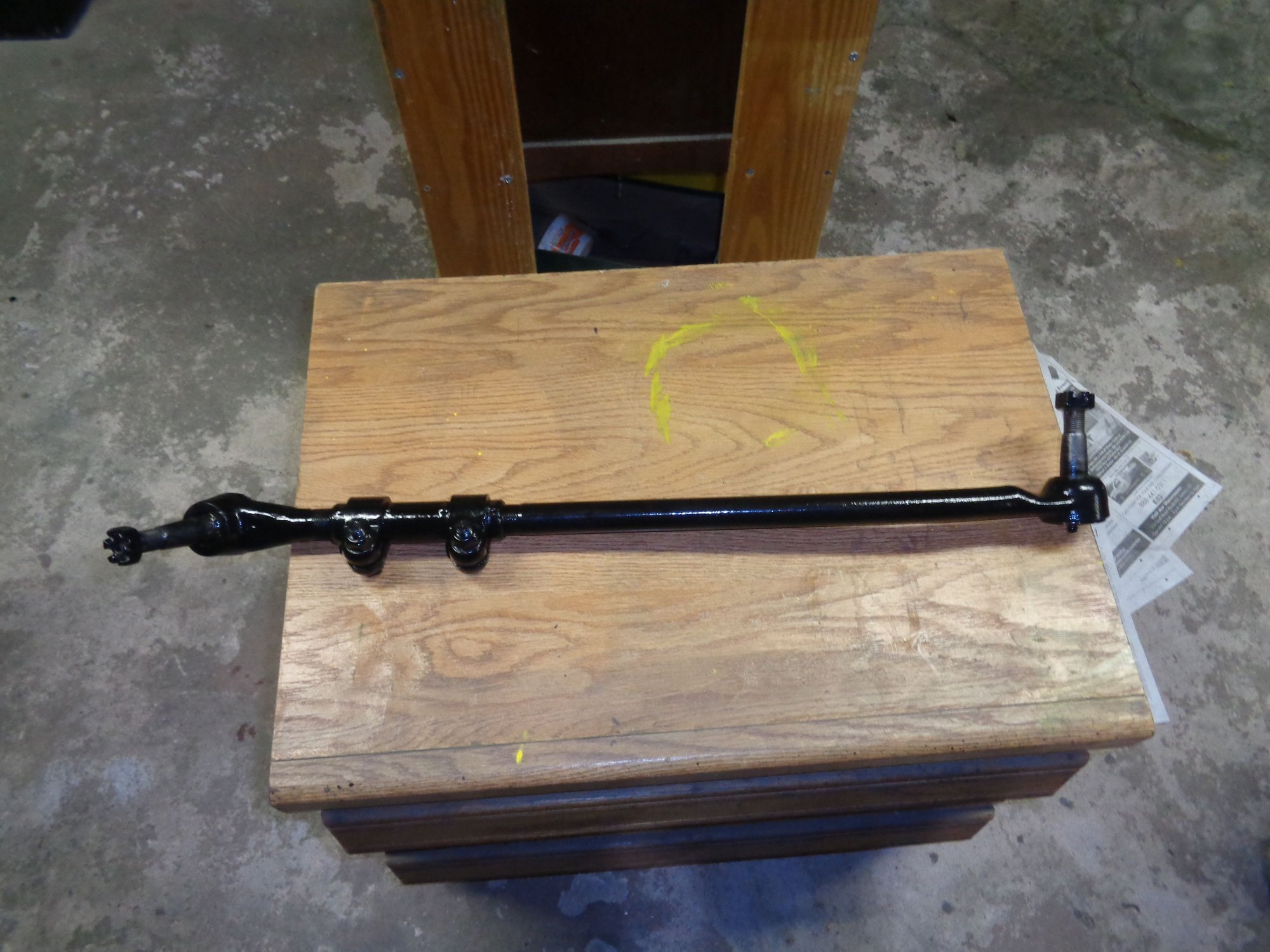

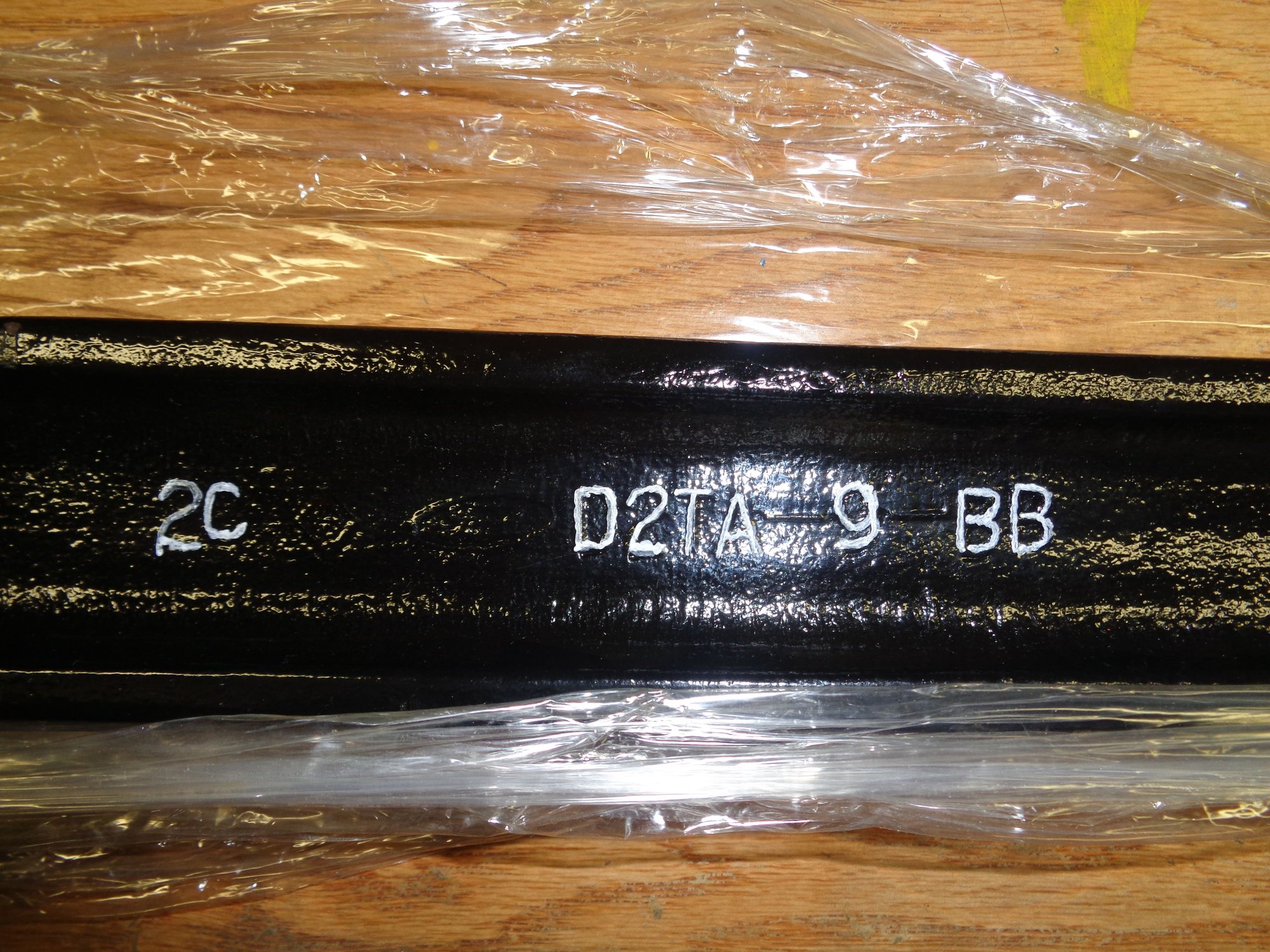

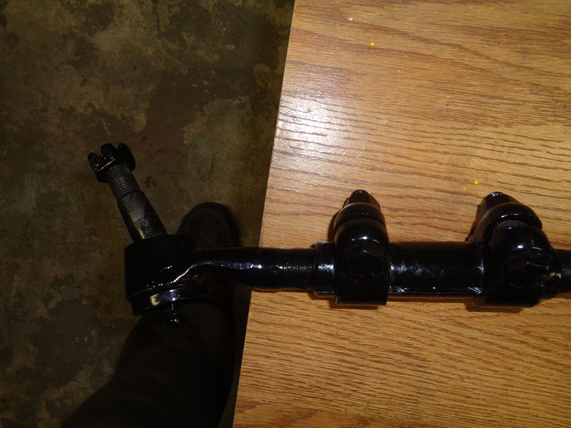

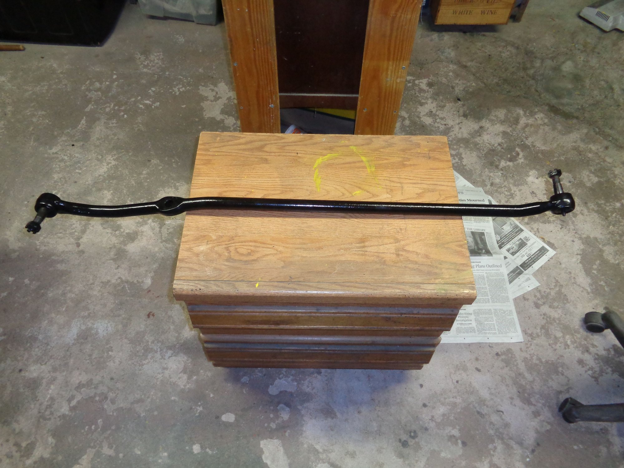

Okay oh Wizards of the Blue Oval I did some searching on this site and I found enough info to know I need new TR ends. The numbers I found on my I-beam (L side) = D2TA-9-BB (R side) =D2TA-8-BB don't help me in picking the ends out of the Rock Auto catalog. Looking at my parts I would say they look most like the "Quick turn" items in the catalog. Any where else I can find info to help? Thanks guys, Todd.
Forgot to mention. It's an F250 with dual piston calipers.
Here are the parts:

D2TZ-3304-A .. Draglink-Studs face in opposite directions / F250: Use with 12" x 2 1/2" rear brakes.
1971 F250 2WD & F350 from serial number M00,001 / 1972/74 F250 2WD & F350 / 1975/79 F250 2WD Regular/Super/Crew Cab with dual piston caliper disc brakes.
1975/78 F350 / 1979 F350 2WD
Note: 1971/72 F250 2WD's with drum front brakes & 12 1/8" x 2" rear brakes; 1973/79 F250 2WD's with single piston caliper disc brakes: Draglink has studs that face in the same direction.
Note: F250 2WD's with I-Beams stamped D2TA-8-BB & D2TA-9-BB have a 7,500 or 8,100 lbs. Gross Vehicle Weight Rating, 12" x 2 1/2" rear brakes.
